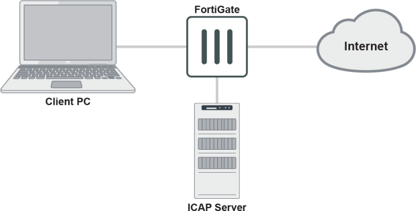

Example
The FortiGate acts as a gateway for the client PC and connects to a reachable ICAP server. The ICAP server can be in NAT, transparent, or proxy mode.
In this example, client request HTTP responses will be forwarded to the ICAP server from all hosts if they have an HTTP status code of 200, 301, or 302, and have content‑type: image/jpeg in the their header.
