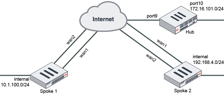

ADVPN with RIP as the routing protocol
This is a sample configuration of ADVPN with RIP as routing protocol. The following options must be enabled for this configuration:
On the hub FortiGate, IPsec phase1-interface
net-device disablemust be run. -
RIP must be used between the hub and spoke FortiGates.
split-horizon-status enablemust be run on the hub FortiGate.
To configure ADVPN with RIP as the routing protocol using the CLI:
In the CLI, configure hub FortiGate's WAN, internal interface, and static route:
config system interface edit "port9" set alias "WAN" set ip 22.1.1.1 255.255.255.0 next edit "port10" set alias "Internal" set ip 172.16.101.1 255.255.255.0 next end config router static edit 1 set gateway 22.1.1.2 set device "port9" next end -

Configure Spoke1:
config system interface edit "wan1" set alias "primary_WAN" set ip 15.1.1.2 255.255.255.0 next edit "wan2" set alias "secondary_WAN" set ip 12.1.1.2 255.255.255.0 next edit "internal" set ip 10.1.100.1 255.255.255.0 next end config router static edit 1 set gateway 12.1.1.1 set device "wan2" set distance 15 next edit 2 set gateway 15.1.1.1 set device "wan1" next end -
Configure the Spoke2:
config system interface edit "wan1" set alias "primary_WAN" set ip 13.1.1.2 255.255.255.0 next edit "wan2" set alias "secondary_WAN" set ip 17.1.1.2 255.255.255.0 next edit "internal" set ip 192.168.4.1 255.255.255.0 next end config router static edit 1 set gateway 17.1.1.1 set device "wan2" set distance 15 next edit 2 set gateway 13.1.1.1 set device "wan1" next end

Configure Spoke1:
config vpn ipsec phase1-interface edit "spoke1" set interface "wan1" set peertype any set net-device enable set proposal aes128-sha256 aes256-sha256 aes128-sha1 aes256-sha1 set add-route disable set dpd on-idle set auto-discovery-receiver enable set remote-gw 22.1.1.1 set psksecret sample set dpd-retryinterval 5 next edit "spoke1_backup" set interface "wan2" set peertype any set net-device enable set proposal aes128-sha256 aes256-sha256 aes128-sha1 aes256-sha1 set add-route disable set dpd on-idle set auto-discovery-receiver enable set remote-gw 22.1.1.1 set monitor "spoke1" set psksecret sample set dpd-retryinterval 5 next end config vpn ipsec phase2-interface edit "spoke1" set phase1name "spoke1" set proposal aes128-sha1 aes256-sha1 aes128-sha256 aes256-sha256 aes128gcm aes256gcm chacha20poly1305 set auto-negotiate enable next edit "spoke1_backup" set phase1name "spoke1_backup" set proposal aes128-sha1 aes256-sha1 aes128-sha256 aes256-sha256 aes128gcm aes256gcm chacha20poly1305 set auto-negotiate enable next end -
Configure Spoke2:
config vpn ipsec phase1-interface edit "spoke2" set interface "wan1" set peertype any set net-device enable set proposal aes128-sha256 aes256-sha256 aes128-sha1 aes256-sha1 set add-route disable set dpd on-idle set auto-discovery-receiver enable set remote-gw 22.1.1.1 set psksecret sample set dpd-retryinterval 5 next edit "spoke2_backup" set interface "wan2" set peertype any set net-device enable set proposal aes128-sha256 aes256-sha256 aes128-sha1 aes256-sha1 set add-route disable set dpd on-idle set auto-discovery-receiver enable set remote-gw 22.1.1.1 set monitor "spoke2" set psksecret sample set dpd-retryinterval 5 next end config vpn ipsec phase2-interface edit "spoke2" set phase1name "spoke2" set proposal aes128-sha1 aes256-sha1 aes128-sha256 aes256-sha256 aes128gcm aes256gcm chacha20poly1305 set auto-negotiate enable next edit "spoke2_backup" set phase1name "spoke2_backup" set proposal aes128-sha1 aes256-sha1 aes128-sha256 aes256-sha256 aes128gcm aes256gcm chacha20poly1305 set auto-negotiate enable next end
