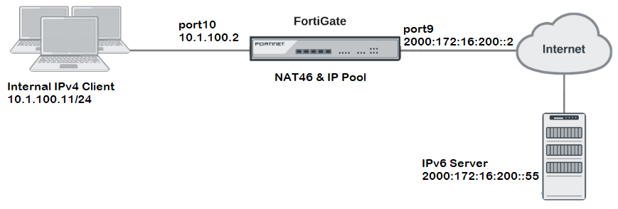

Sample topology
In this example, an IPv4 client tries to connect to an IPv6 server. A VIP is configured on FortiGate to map the server IPv6 IP address 2000:172:16:200:55 to an IPv4 address 10.1.100.55. On the other side, an IPv6 IP pool is configured and the source address of packets from client are changed to the defined IPv6 address. In this setup, the client PC can access the server by using IP address 10.1.100.55.
