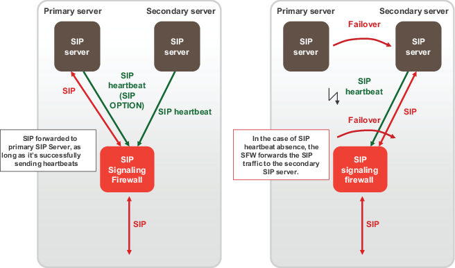

Maintains a active-standby SIP server configuration, which even supports geographical distribution. If the active SIP server fails (missing SIP heartbeat messages or SIP traffic) FortiOS will redirect the SIP traffic to a secondary SIP server. No special configuration is required for geographic redundancy, just standard HA configuration.
