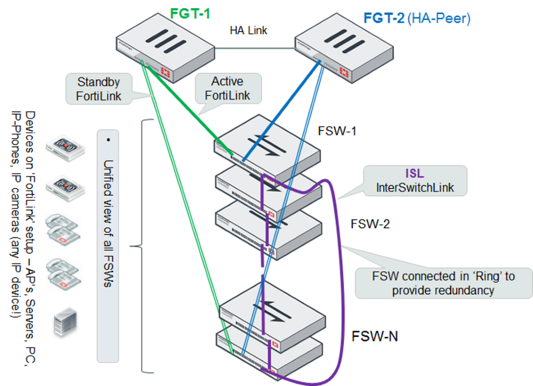

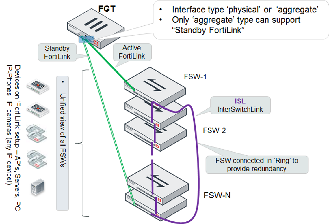

Single FortiGate unit managing a stack of several FortiSwitch units
The FortiGate unit connects directly to one FortiSwitch unit using a physical or aggregate interface. The remaining FortiSwitch units connect in a ring using inter-switch links (that is, ISL).
Optionally, you can connect a standby FortiLink connection to the last FortiSwitch unit. For this configuration, you create a FortiLink Split-Interface (an aggregate interface that contains one active link and one standby link).

HA-mode FortiGate units managing a stack of several FortiSwitch units
The primary and secondary FortiGate units both connect a FortiLink to the first FortiSwitch unit and (optionally) to the last FortiSwitch unit. The FortiLink ports and interface type must match on the two FortiGate units.

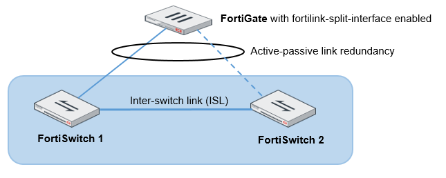

For the active/standby FortiLink configuration, you create a FortiLink Split-Interface (an aggregate interface that contains one active link and one standby link).

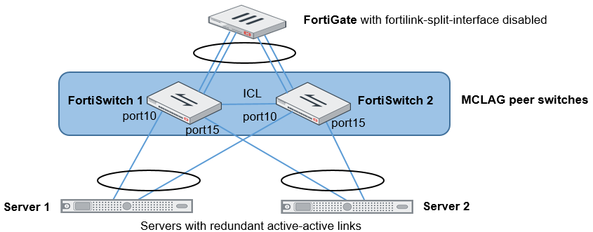

Dual-homed servers connected to a pair of FortiSwitch units using an MCLAG
To configure a multichassis LAG, you need to configure FortiSwitch 1 and FortiSwitch 2 as MCLAG peer switches before creating a two-port LAG. Use the set mclag-icl enable command to create an inter-chassis link (ICL) on each FortiSwitch unit. Then you set up two MCLAGs towards the servers, each MCLAG using one port from each FortiSwitch unit.
This topology is supported when the FortiGate unit is in HA mode.
To set up Server 1:
config switch trunk
edit server_1
set members port10
set mclag enable
edit server_2
set members port15
set mclag enable
To set up Server 2:
config switch trunk
edit server_1
set members port10
set mclag enable
edit server_2
set members port15
set mclag enable
If you disable the MCLAG ICL (with the set mclag-icl disable command), you need to enable the fortilink-split-interface.

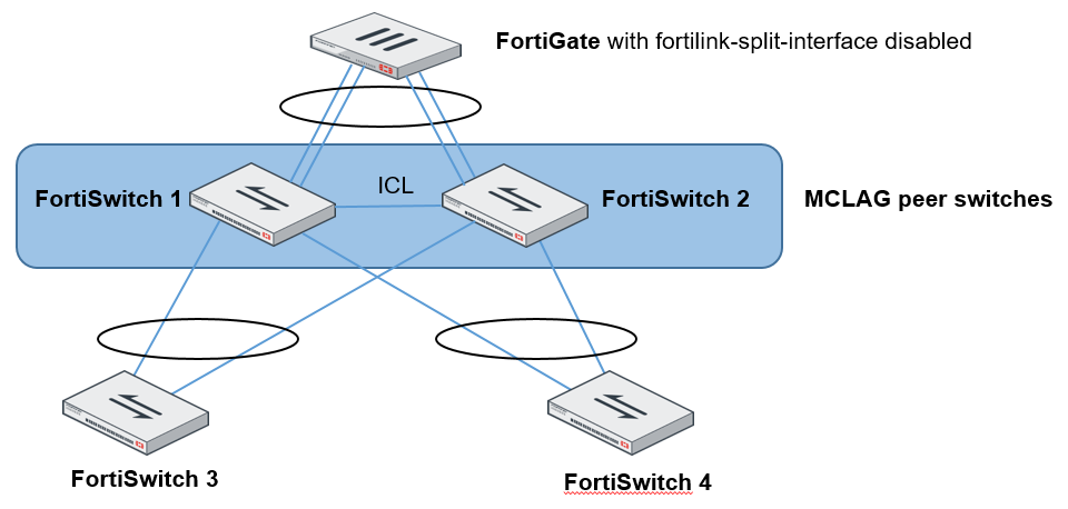

Standalone FortiGate unit with dual-homed FortiSwitch access
This network topology provides high port density with two tiers of FortiSwitch units.
Use the set mclag-icl enable command to create an ICL on each FortiSwitch unit.

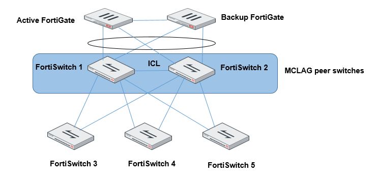

HA-mode FortiGate units with dual-homed FortiSwitch access
In HA mode, only one FortiGate is active at a time. If the active FortiGate unit fails, the backup FortiGate unit becomes active.
NOTE: When using HA-mode FortiGate units to manage FortiSwitch units, the HA mode must be active-passive.

Transitioning from a FortiLink split interface to a FortiLink MCLAG
In this topology, the FortiLink split interface connects a FortiLink aggregate interface from one FortiGate unit to two FortiSwitch units.
NOTE:
  • This procedure also applies to a FortiGate unit in HA mode.
  • More links can be added between the FortiGate unit and FortiSwitch unit.
  • After the MCLAG is set up, only connect the tier-2 FortiSwitch units.
  • When you are using the aggregate interface on the FortiGate unit for the FortiLink interface, the lacp-mode of the FortiLink aggregate interface must be set to static.
  1. Enable the split interface on the FortiLink aggregate interface. By default, the split interface is enabled. For example:
    config system interface
    edit flinksplit1
    set ip 169.254.3.1 255.255.255.0
    set allowaccess ping capwap https
    set vlanforward enable
    set type aggregate
    set member port4 port5
    set lacp-mode static
    set fortilink enable
    set fortilink-split-interface enable
NOTE:
  • External devices shown in the following topology must be compliant endpoints, such as computers. They cannot be third-party switches or appliances.
NOTE:
  • When using HA-mode FortiGate units to manage FortiSwitch units, the HA mode must be active-passive.
To set up Server 1:
config switch trunk
edit server_1
set members port10
set mclag enable
edit server_2
set members port15
set mclag enable
To set up Server 2:
config switch trunk
edit server_1
set members port10
set mclag enable
edit server_2
set members port15
set mclag enable
    edit flinksplit1
    set type aggregate
  2. Log into FortiSwitch 2 using the Connect to CLI button in the FortiGate GUI, use the get switch lldp auto-isl-status command to find out the name of the trunk connecting the peer switches, and change the ISL to an ICL. For example:
    config switch trunk
    edit <trunk_name>
  3. Log into FortiSwitch 1 using the Connect to CLI button in the FortiGate GUI, use the get switch lldp auto-isl-status command to find out the name of the trunk connecting the peer switches, and change the ISL to an ICL. For example:
    config switch trunk
    edit <trunk_name>
  4. Log into the FortiGate unit and disable the split interface. For example:
    edit flinksplit1
    set fortilink-split-interface disable
  5. Enable the LACP active mode.
  6. Check that the LAG is working correctly. For example:
  7. diagnose netlink aggregate name <aggregate_name>
