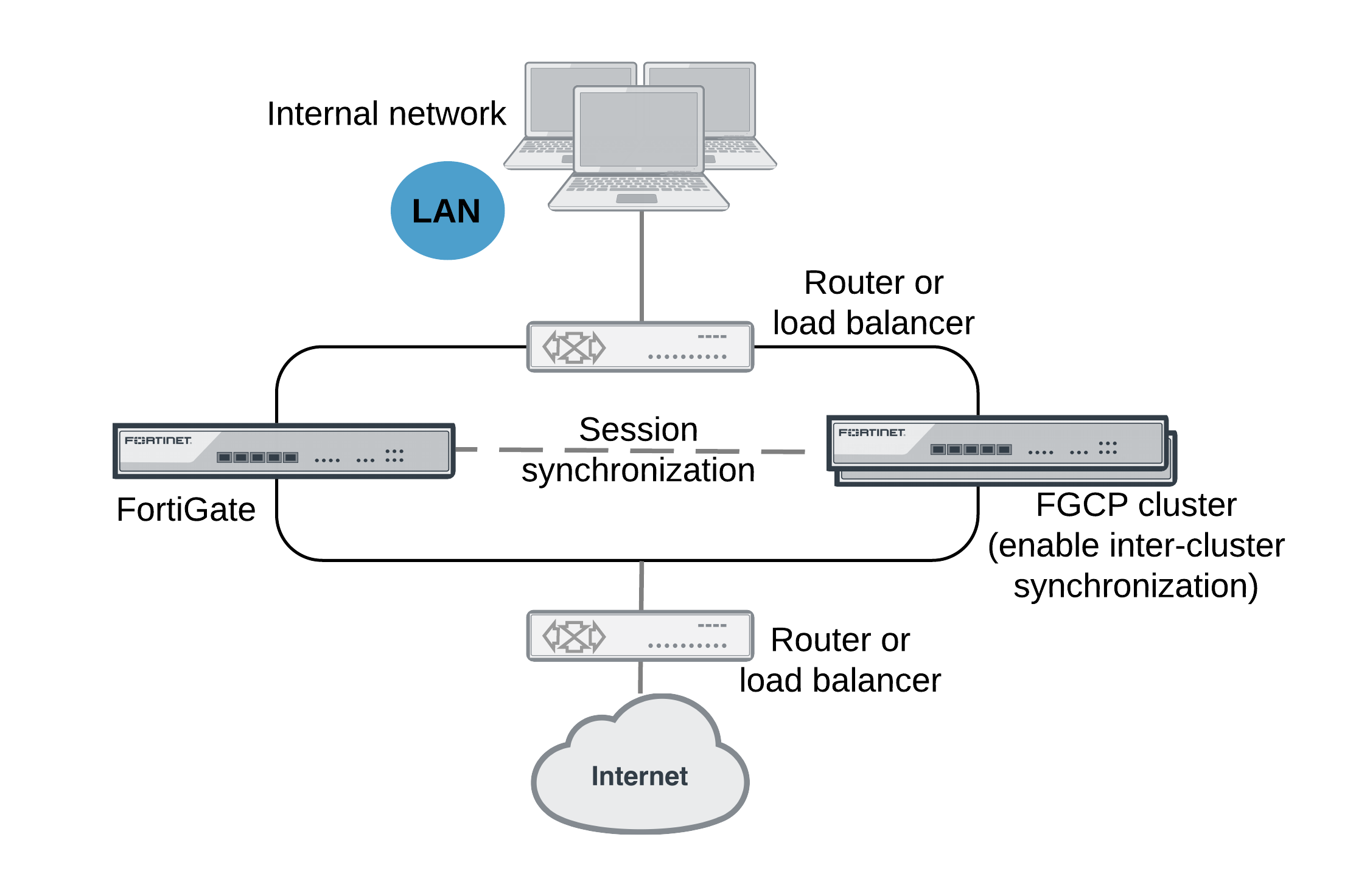

Session synchronization between FGCP clusters (also called inter-cluster session synchronization) allows you to synchronize sessions among FGCP clusters and standalone FortiGates. The FGSP can synchronize sessions among up to four FGCP clusters and FortiGates.
Example session synchronization between a FortiGate and an FGCP cluster
Enter the following command to enable inter-cluster synchronization on an FGCP cluster:
config system ha
set inter-cluster-session-sync enable
Once you enable inter-cluster session synchronization, all FGSP configuration options are available in the FGCP cluster CLI and you can set up the FGSP configuration in the same way as for standalone FortiGates.

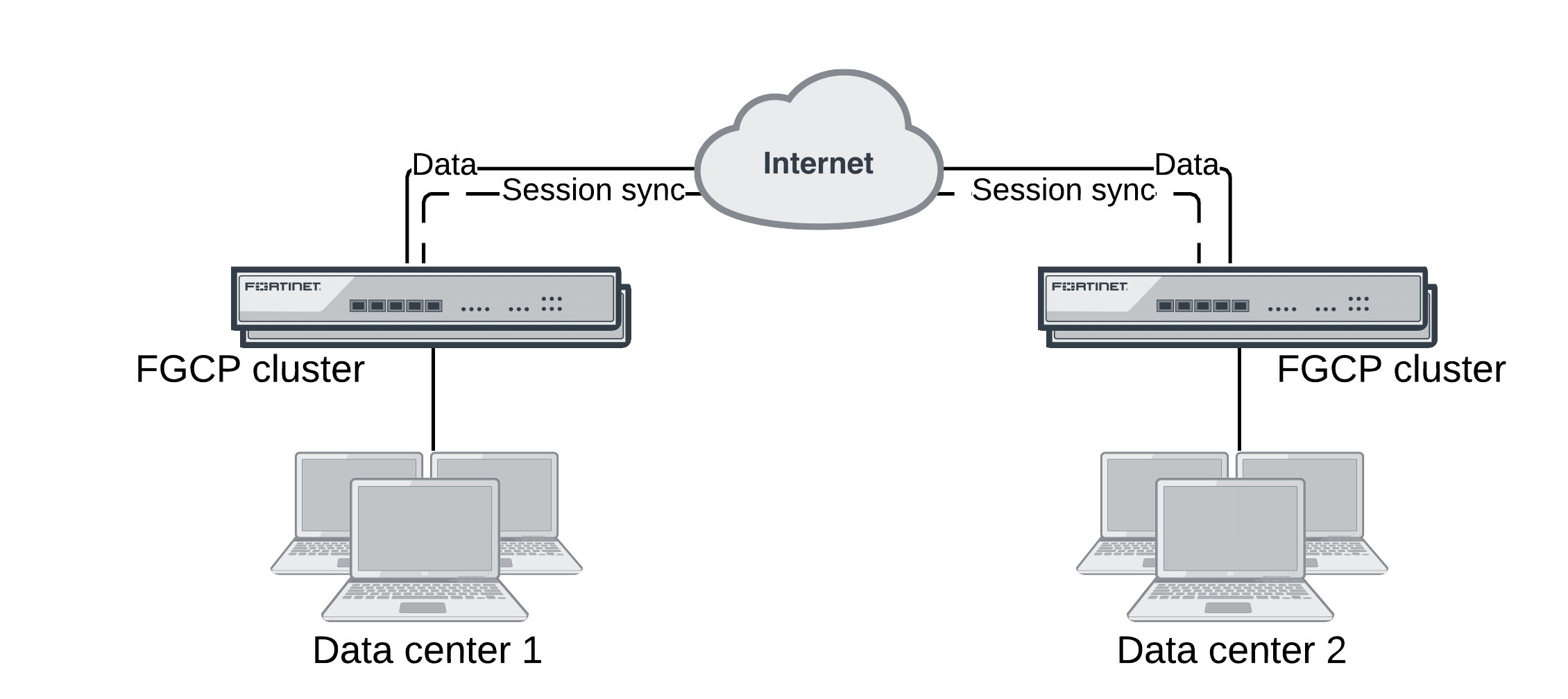

Inter-cluster synchronization between data centers
Inter-cluster session synchronization is deployed for session-synchronization among multiple data centers if one or more of the data centers is protected by an FGCP cluster.
Example inter-cluster session synchronization between two data centers
In this example, you enable inter-cluster session synchronization for both of the clusters, and then configure session synchronization options on each cluster, as required.
config system ha
