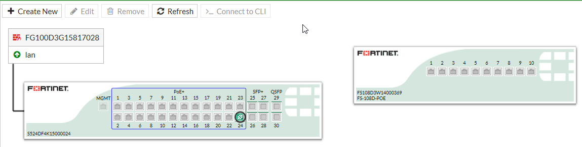

Managed FortiSwitch display
Go to WiFi & Switch Controller > Managed FortiSwitch to see all of the switches being managed by your FortiGate.
When the FortiLink is established successfully, the status is green (next to the FortiGate interface name and on the FortiSwitch faceplate), and the link between the ports is a solid line.
If the link has gone down for some reason, the line will be dashed, and a broken link icon will appear. You can still edit the FortiSwitch unit though and find more information about the status of the switch. The link to the FortiSwitch unit might be down for a number of reasons; for example, a problem with the cable linking the two devices, firmware versions being out of synch, and so on. You need to make sure the firmware running on the FortiSwitch unit is compatible with the firmware running on the FortiGate unit.
From the Managed FortiSwitch page, you can edit any of the managed FortiSwitch units, remove a FortiSwitch unit from the configuration, refresh the display, connect to the CLI of a FortiSwitch unit, or deauthorize a FortiSwitch unit.

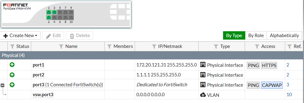

Network interface display
On the Network > Interfaces page, you can see the FortiGate interface connected to the FortiSwitch unit. The GUI indicates Dedicated to FortiSwitch in the IP/Netmask field.

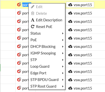

Configure DHCP blocking, IGMP snooping, STP, and loop guard on managed FortiSwitch ports
Go to WiFi & Switch Controller > FortiSwitch Ports. Right-click any port and then enable or disable the following features:
  • DHCP blocking—The DHCP blocking feature monitors the DHCP traffic from untrusted sources (for example, typically host ports and unknown DHCP servers) that might initiate traffic attacks or other hostile actions. To prevent this, DHCP blocking filters messages on untrusted ports.
  • IGMP snooping—IGMP snooping allows the FortiSwitch to passively listen to the Internet Group Management Protocol (IGMP) network traffic between hosts and routers. The switch uses this information to determine which ports are interested in receiving each multicast feed. FortiSwitch can reduce unnecessary multicast traffic on the LAN by pruning multicast traffic from links that do not contain a multicast listener.
  • Spanning Tree Protocol (STP)—STP is a link-management protocol that ensures a loop-free layer-2 network topology.
  • Loop guard—A loop in a layer-2 network results in broadcast storms that have far-reaching and unwanted effects. Fortinet loop guard helps to prevent loops. When loop guard is enabled on a switch port, the port monitors its subtending network for any downstream loops. The loop guard feature is designed to work in concert with STP rather than as a replacement for STP.
  • STP root guard—Root guard protects the interface on which it is enabled from becoming the path to root. When enabled on an interface, superior BPDUs received on that interface are ignored or dropped. Without using root guard, any switch that participates in STP maintains the ability to reroute the path to root. Rerouting might cause your network to transmit large amounts of traffic across suboptimal links or allow a malicious or misconfigured device to pose a security risk by passing core traffic through an insecure device for packet capture or inspection. By enabling root guard on multiple interfaces, you can create a perimeter around your existing paths to root to enforce the specified network topology.
  • STP BPDU guard—Similar to root guard, BPDU guard protects the designed network topology. When BPDU guard is enabled on STP edge ports, any BPDUs received cause the ports to go down for a specified number of minutes. The BPDUs are not forwarded, and the network edge is enforced.
STP is enabled on all ports by default. Loop guard is disabled by default on all ports.
