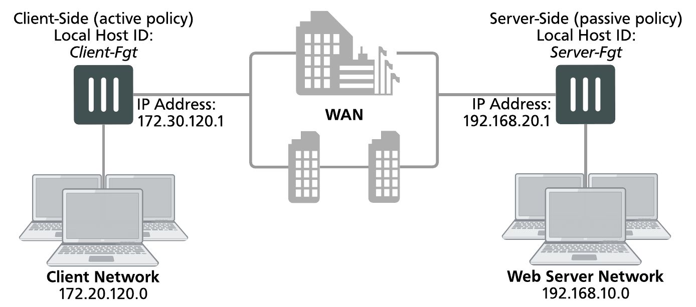

This example shows how to configure two FortiGate units for active-passive WAN optimization with secure tunneling. The same authentication group is added to both FortiGate units. The authentication group includes a password (or pre-shared key) and has Peer Acceptance set to Accept any Peer. An active policy is added to the client-side FortiGate unit and a passive policy to the server-side FortiGate unit. The active policy includes a profile that performs secure tunneling, optimizes HTTP traffic, and uses transparent mode and byte caching.
The authentication group is named Auth-Secure-Tunnel and the password for the pre-shared key is 2345678. The topology for this example is shown below. This example includes GUI configuration steps followed by equivalent CLI configuration steps. For information about secure tunneling, see .
Network topology and assumptions
This example configuration includes a client-side FortiGate unit called Client-net with a WAN IP address of 172.30.120.1.This unit is in front of a network with IP address 172.20.120.0. The server-side FortiGate unit is called Web-servers and has a WAN IP address of 192.168.20.1. This unit is in front of a web server network with IP address 192.168.10.0.
Example active-passive WAN optimization and secure tunneling topology

    Peer Host IDClient-Fgt
    IP Address172.30.120.1
  5. Select OK.
  6. Go to WAN Opt. & Cache > Authentication Groups and select Create New and add an authentication group to be used for secure tunneling:
    NameAuth-Secure-Tunnel
    Authentication MethodPre-shared key
    Password2345678
    Peer AcceptanceAccept Any Peer
  7. Select OK.
  8. Go to Policy & Objects > Addresses and select Create New to add a firewall address for the client network.
    CategoryAddress
    NameClient-Net
    TypeSubnet
    Subnet / IP Range172.20.120.0/24
    Interfaceport1
  9. Select Create New to add a firewall address for the web server network.
    CategoryAddress
    Address NameWeb-Server-Net
    TypeSubnet
    Subnet / IP Range192.168.10.0/24
    Interfaceport2
  10. Select OK.
  11. Select Create New to add a passive WAN optimization policy that applies application control.
    Incoming Interfaceport2
    Source AddressClient-Net
    Outgoing Interfaceport1
    Destination AddressWeb-Server-Net
    Schedulealways
    ServiceALL
    ActionACCEPT
  12. Turn on WAN Optimization and configure the following settings:
    WAN Optimizationpassive
    Passive Optiondefault
  13. Select OK.
  14. From the CLI enter the following command to add a WAN optimization tunnel explicit proxy policy.
    configure firewall proxy-policy
    edit 0
    set proxy wanopt
    set dstintf port1
    set srcaddr all
    set dstaddr all
    set schedule always
    set service ALL
Configuring WAN optimization with secure tunneling - CLI
Use the following steps to configure the example WAN optimization configuration from the client-side and server-side FortiGate unit CLI.
To the client-side FortiGate unit
  1. Add the Local Host ID to the client-side FortiGate configuration:
    config wanopt settings
    set host-id Client-Fgt
  2. Add the server-side Local Host ID to the client-side peer list:
    config wanopt peer
    edit Server-Fgt
    set ip 192.168.20.1
  3. Add a new authentication group to be used for secure tunneling:
    config wanopt auth-group
    edit Auth-Secure-Tunnel
    set auth-method psk
    set psk 2345678
    Leave peer-accept at its default value.
  4. Add a WAN optimization profile that enables secure tunneling and includes the authentication group, enables HTTP protocol optimization, and enables secure tunneling and byte caching for HTTP traffic:
    config wanopt profile
    edit Secure-wan-op-pro
    set auth-group Auth-Secure-Tunnel
    config http
    set status enable
    set secure-tunnel enable
    set byte-caching enable
    set port 80
  5. Add a firewall address for the client network.
    config firewall address
    edit Client-Net
    set type ipmask
    set subnet 172.20.120.0 255.255.255.0
    set associated-interface port1
  6. Add a firewall address for the web server network.
    edit Web-Server-Net
    set type ipmask
    set subnet 192.168.10.0 255.255.255.0
    set associated-interface port2
  7. Add an active WAN optimization security policy that includes the WAN optimization profile that enables secure tunneling and that applies virus scanning:
    config firewall policy
    edit 0
    set srcintf port1
    set dstintf port2
    set srcaddr Client-Net
    set dstaddr Web-Server-Net
    set service HTTP
    set schedule always
    set wanopt enable
    set wanopt-detection active
    set wanopt-profile Secure-wan-opt-pro
To configure the server-side FortiGate unit
  1. Add the Local Host ID to the server-side FortiGate configuration:
    set host-id Server-Fgt
  2. Add the client-side Local Host ID to the server-side peer list:
    config wanopt peer
    edit Client-Fgt
    set ip 172.20.120.1
  3. Add an authentication group to be used for secure tunneling:
    set auth-method psk
    set psk 2345678
  4. Add a firewall address for the client network.
    edit Client-Net
    set type ipmask
  5. Add a firewall address for the web server network.
    edit Web-Server-Net
    set type ipmask
  6. Add a passive WAN optimization policy.
    edit 0
    set srcintf port1
    set dstintf port2
    set service ALL
    set schedule always
    set wanopt enable
    set wanopt-detection passive
    set wanopt-passive-opt default
  7. Add a WAN optimization tunnel explicit proxy policy.
    edit 0
    set proxy wanopt
    set dstintf port1
    set srcaddr all
    set dstaddr all
    set schedule always
    set service ALL
