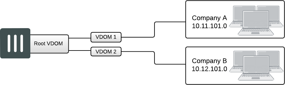

Independent VDOMs
Independent VDOMs is a common configuration. In this configuration, you create multiple VDOMs that are completely separate from each other, without any inter-VDOM routing. Any VDOM in this configuration can be the management VDOM, provided there is Internet access.
This configuration can be used when more than one department or company shares the FortiGate. Using independent VDOMs, each company or department appears to have its own FortiGate, which can be independently managed.

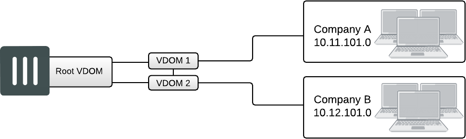

Independent VDOMs
