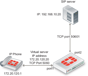

Using port forwarding virtual IPs you can change the destination port of SIP sessions as they pass through the FortiGate.
Translating SIP sessions to a different destination port
To configure translating SIP sessions to a different destination port you must add a static NAT virtual IP that translates tie SIP destination port to another port destination. In the example the destination port is translated from 5060 to 50601. This configuration can be used if SIP sessions uses different destination ports on different networks.
Example translating SIP sessions to a different destination port
To translate SIP sessions to a different destination port
  1. Add the static NAT virtual IP.
    This virtual IP forwards traffic received at the port1 interface for IP address 172.20.120.20 and destination port 5060 to the SIP server at IP address 192.168.10.20 with destination port 5061.
  2. config firewall vip
    edit "sip_port_trans_vip"
    set type static-nat
    set portforward enable
    set protocol tcp
    set extip 172.20.120.20
    set extport 5060
    set extintf "port1"
    set mappedip 192.168.10.20
    set mappedport 50601
    set comment "Translate SIP destination port"
  3. Add a security policy that includes the virtual IP and the default VoIP profile.
  4. config firewall policy
    set srcintf "port1"
    set dstintf "port2"
    set srcaddr "all"
    set dstaddr "sip_port_trans_vip"
    set service "ALL"
    set utm-status enable
    set profile-protocol-options default
    set comments "Translate SIP destination port"
    set type static-nat
    set protocol tcp
    set extport 5060
    set extintf "port1"
    set srcintf "port1"
    set dstintf "port2"
    set srcaddr "all"
    set service "ALL"
