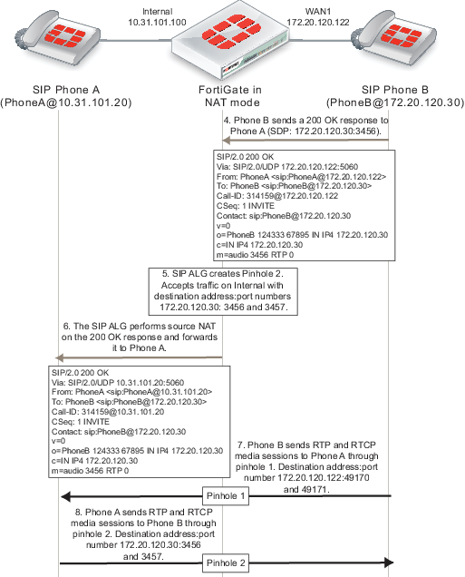

Phone B sends the 200 OK response to the INVITE message to the WAN1 interface. The SDP profile includes the port number that Phone B wants to use for its media stream. The FortiGate forwards 200 OK response to Phone A after translating the addresses in the SIP and SDP lines back to the IP address of Phone A. The SIP ALG also opens a pinhole on the Internal interface that accepts media stream sessions from Phone A with destination address set to the IP address of Phone B and using the port that Phone B added to the SDP m= line.
SIP source NAT scenario part 2: 200 OK returned and media streams established
