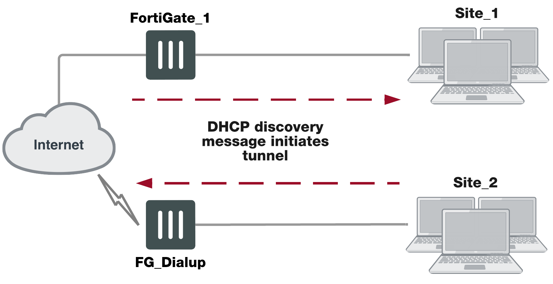

In some cases, computers on the private network behind the FortiGate dialup client may (by co-incidence) have IP addresses that are already used by computers on the network behind the FortiGate dialup server. In this type of situation (ambiguous routing), conflicts may occur in one or both of the FortiGate routing tables and traffic destined for the remote network through the tunnel may not be sent.
In many cases, computers on the private network behind the FortiGate dialup client will most likely obtain IP addresses from a local DHCP server behind the FortiGate dialup client. However, unless the local and remote networks use different private network address spaces, unintended ambiguous routing and IP-address overlap issues may arise.
To avoid these issues, you can configure FortiGate DHCP relay on the dialup client instead of using a DHCP server on the network behind the dialup client. The FortiGate dialup client can be configured to relay DHCP requests from the local private network to a DHCP server that resides on the network behind the FortiGate dialup server. You configure the FortiGate dialup client to pass traffic from the local private network to the remote network by enabling FortiGate DHCP relay on the FortiGate dialup client interface that is connected to the local private network.
Afterward, when a computer on the network behind the dialup client broadcasts a DHCP request, the dialup client relays the message through the tunnel to the remote DHCP server. The remote DHCP server responds with a private IP address for the computer. To avoid ambiguous routing and network overlap issues, the IP addresses assigned to computers behind the dialup client cannot match the network address space used by the private network behind the FortiGate dialup server.
Preventing network overlap in a FortiGate dialup-client configuration
When the DHCP server resides on the private network behind the FortiGate dialup server, the IP destination address specified in the IPsec security policy on the FortiGate dialup client must refer to that network.
    note icon You must add a static route to the DHCP server FortiGate unit if it is not directly connected to the private network behind the FortiGate dialup server; its IP address does not match the IP address of the private network. Also, the destination address in the IPsec security policy on the FortiGate dialup client must refer to the DHCP server address. The DHCP server must be configured to assign a range of IP addresses different from the DHCP server's local network, and also different from the private network addresses behind the FortiGate dialup server. See Routing.
