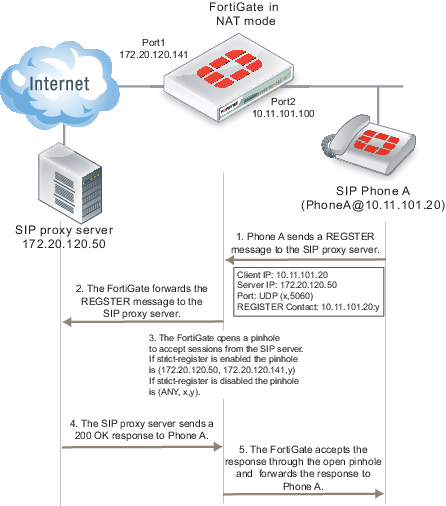

In a typical SOHO scenario, shown below, SIP Phone A is being protected from the Internet by a FortiGate. In most cases the FortiGate would not allow incoming traffic from the Internet to reach the private network. So the only way that an INVITE request from the SIP server can reach SIP Phone A is if the SIP ALG creates an incoming pinhole. All pinholes have three attributes:
(source address, destination address, destination port)
SOHO configuration, FortiGate protecting a network with SIP phones
The more specific a pinhole is the more secure it is because it accept less traffic. In this situation, the pinhole would be more secure if it only accepted traffic from the SIP server. This is what happens if strict-register is enabled in the VoIP profile that accepts the REGISTER request from Phone A.
(SIP server IP address, client IP address, destination port)
If strict-register is disabled (the default configuration) the pinhole is set up with the following attributes
(All IP addresses, client IP address, destination port)
This pinhole allows connections through the FortiGate from all source addresses which is a much bigger and less secure pinhole. In most similar network configurations you should enable strict‑register to improve pinhole security.
