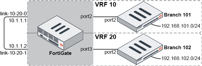

Route leaking allows you to configure communication between VRFs. If route leaking is not configured, then the VRFs are isolated. This example shows route leaking with BGP using virtual inter-VDOM links.
In this example, a hub FortiGate forms BGP neighbors with two branches. It learns the networks 192.168.101.0/24 and 192.168.102.0/24 from the neighbors and separates them into VRF 10 and VRF 20.
To leak the learned routes to each other, an inter-VDOM link (IVL) is formed. An IVL normally bridges two VDOMs, but in this case the links reside on the same VDOM and are used to bridge the two VRFs. NPU links could also be used on models that support it to deliver better performance.
VRF 10 has a leaked route to 192.168.102.0/24 on IVL link-10-20-0, and VRF 20 has a leaked route to 192.168.101.0/24 on IVL link-10-20-1,
