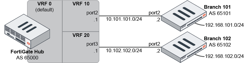

BGP example 1: update VRF neighbors
In this example, BGP is used to update the VRF that it is neighbors with.
The hub is configured with two neighbors connected to two interfaces. The branches are configured to match the hub, with branch networks configured to redistribute into BGP.
Policies must be created on the hub and branches to allow traffic between them.

To verify the BGP neighbors and check the routing table on the hub:
# get router info bgp summary BGP router identifier 192.168.0.1, local AS number 65000 BGP table version is 2 2 BGP AS-PATH entries 0 BGP community entries Neighbor V AS MsgRcvd MsgSent TblVer InQ OutQ Up/Down State/PfxRcd 10.101.101.2 4 65101 4 4 2 0 0 00:01:05 3 10.102.102.2 4 65102 3 3 1 0 0 00:00:30 3 Total number of neighbors 2
# get router info routing-table all Routing table for VRF=0 Codes (…) S* 0.0.0.0/0 [10/0] via 192.168.0.254, port1 C 10.101.101.0/24 is directly connected, port2 C 10.102.102.0/24 is directly connected, port3 C 192.168.0.0/24 is directly connected, port1 B 192.168.101.0/24 [20/0] via 10.101.101.2, port2, 00:01:25 B 192.168.102.0/24 [20/0] via 10.102.102.2, port3, 00:00:50
To configure VRF on the hub:
Put the interfaces into VRF:
config system interface edit port2 set vrf 10 next edit port3 set vrf 20 next end -
Restart the router to reconstruct the routing tables:
# execute router restart
Check the routing tables:
# get router info routing-table all Routing table for VRF=0 Codes (…) S* 0.0.0.0/0 [10/0] via 192.168.0.254, port1 C 192.168.0.0/24 is directly connected, port1 Routing table for VRF=10 C 10.101.101.0/24 is directly connected, port2 B 192.168.101.0/24 [20/0] via 10.101.101.2, port2, 00:02:25 Routing table for VRF=20 C 10.102.102.0/24 is directly connected, port3 B 192.168.102.0/24 [20/0] via 10.102.102.2, port2, 00:01:50
Check the BGP summary:
# get router info bgp summary VRF 10 BGP router identifier 10.101.101.1, local AS number 65000 BGP table version is 1 2 BGP AS-PATH entries 0 BGP community entries Neighbor V AS MsgRcvd MsgSent TblVer InQ OutQ Up/Down State/PfxRcd 10.101.101.2 4 65101 4 4 2 0 0 00:02:05 3 Total number of neighbors 1 VRF 10 BGP router identifier 10.101.101.1, local AS number 65000 BGP table version is 1 2 BGP AS-PATH entries 0 BGP community entries Neighbor V AS MsgRcvd MsgSent TblVer InQ OutQ Up/Down State/PfxRcd 10.102.102.2 4 65102 3 3 1 0 0 00:01:30 3 Total number of neighbors 1

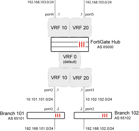

BGP example 2: use overlapping subnets
Building on BGP example 1: update VRF neighbors, example 2 includes two additional interfaces assigned to different VRFs: port4 belongs to VRF 10, and port5 belongs to VRF 20. The IP address and subnet configuration on port4 and port5 are identical, resulting in subnet overlap.
The hub needs to selectively advertise the overlapping prefix through BGP only to the peer within VRF 10. By default, the config network command of BGP does not advertise prefix on a per-VRF basis.
Thus to achieve selective route advertisement to a BGP peer belonging to specific VRF, route maps can be used.
