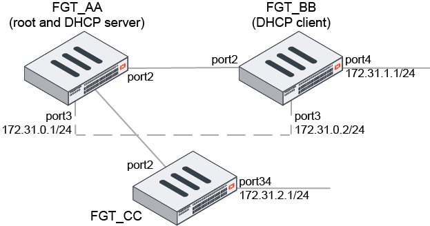

In this example, FGT_AA is the Security Fabric root with IPAM enabled. FGT_BB and FGT_CC are downstream Fabric devices and retrieve IPAM information from FGT_AA. The Fabric interface on all FortiGates is port2. FGT_AA acts as the DHCP server, and FGT_BB acts as the DHCP client.

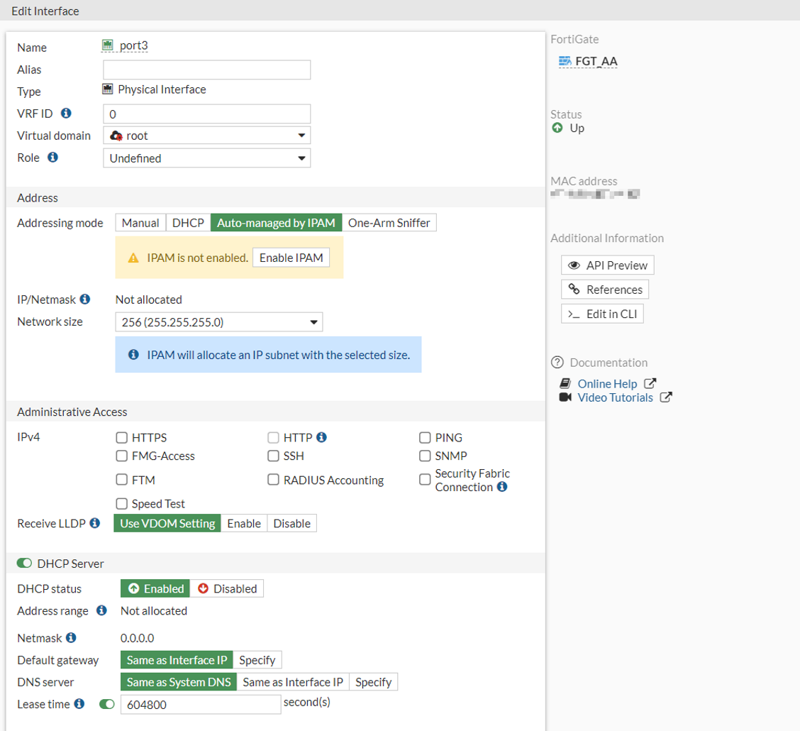

On the root FortiGate, go to Network > Interfaces and edit port3.
For Addressing Mode, select Auto-Managed by IPAM. DHCP Server is automatically enabled.
In this example, IPAM is not enabled yet. Click Enable IPAM. The Subnets Managed by IPAM pane opens.

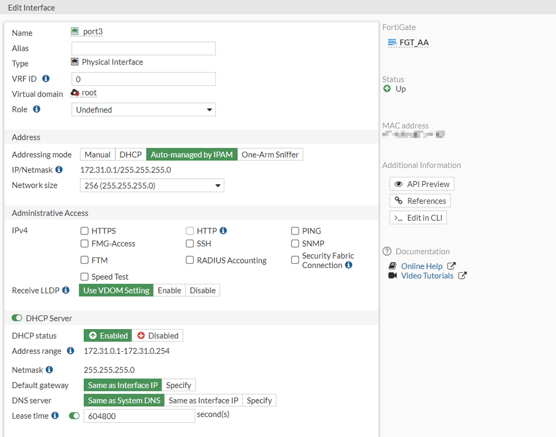

Select Enabled, enter the Pool subnet (only class A and B are allowed) and click OK. The root FortiGate is now the IPAM server in the Security Fabric.
The following is configured in the backend:
config system interface edit "port3" set vdom "root" set ip 172.31.0.1 255.255.0.0 set type physical set device-identification enable set snmp-index 5 set ip-managed-by-fortiipam enable end next end config system ipam set status enable endIPAM is managing a 172.31.0.0/16 network and assigned port3 a /24 network by default.
The IP/Netmask field in the Address section has been automatically assigned a class C IP by IPAM. The Address range and Netmask fields in the DHCP Server section have also been automatically configured by IPAM.
Click OK.
Log in to FGT-BB and set the Addressing Mode of port4 to Auto-Managed by IPAM. The subnet assigned from the pool on the root is 172.31.1.1/24.
Log in to FG_CC and set the Addressing Mode of port34 to Auto-Managed by IPAM. The subnet assigned from the pool on the root is 172.31.2.1/24.
Any interface on a downstream FortiGate can be managed by the IPAM server. The interface does not have to be directly connected to the Fabric root FortiGate. |

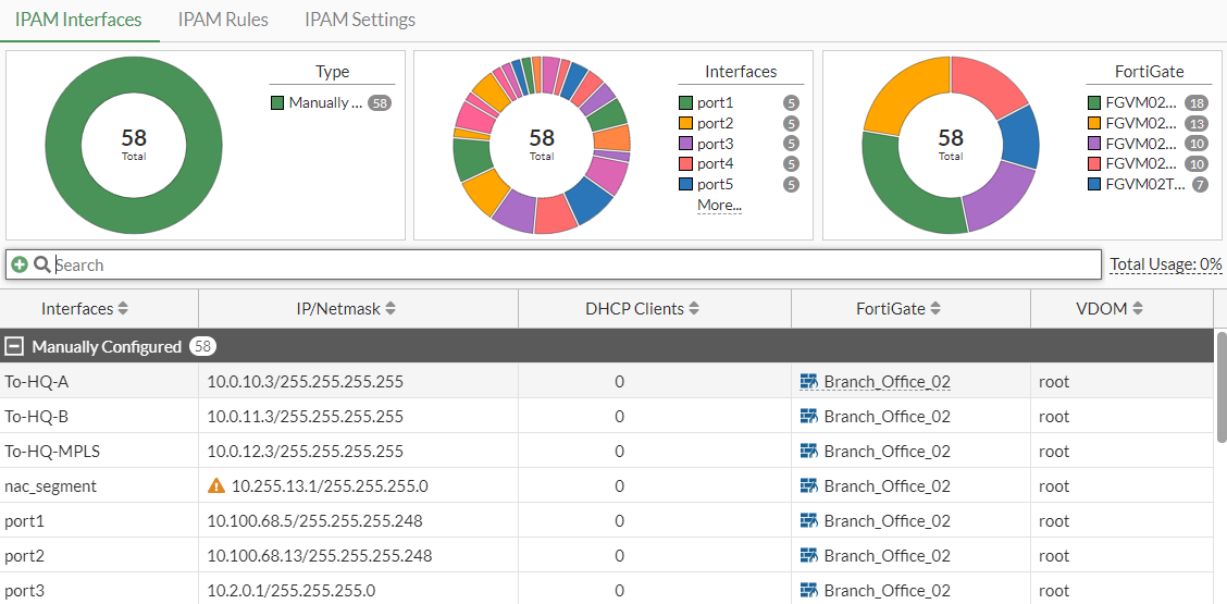

Go to Network > IPAM > IPAM Interfaces to view the subnet allocations (port34, port3, and port3) and DHCP lease information. On FGT_BB, port3 is a DHCP client and the DHCP server interface (FGT_AA port3) is managed by IPAM, so it is displayed in the Manually Configured section. |
IPAM conflict markers

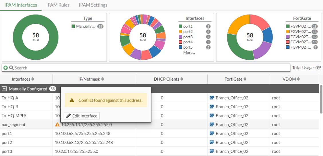

The IPAM Interfaces tab displays conflict markers when there are IP pool IP address conflicts with manually configured IP addresses. Administrators can use the Edit Interface dialog to manually resolve the conflict.
To resolve conflicts in the GUI:
Go to Network > IPAM > IPAM Interfaces.
Hover your mouse over the conflict marker. The conflict marker information is displayed.

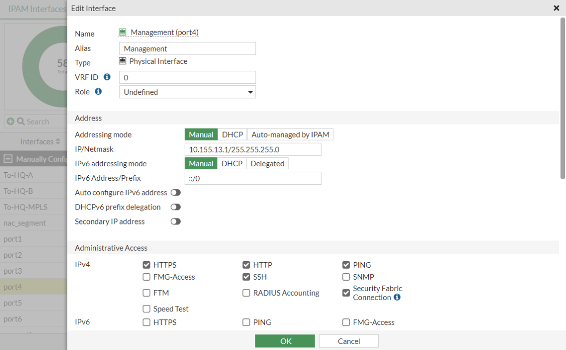

Click Edit Interface. The Edit Interface pane opens.
Enter a new IP address and netmask in the IP/Netmask field.
Click OK. A confirmation message is displayed.
Click OK.
