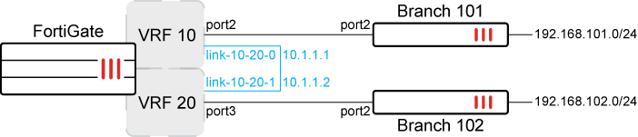

In this example, a hub FortiGate forms BGP neighbors with two branches. It learns the networks 192.168.101.0/24 and 192.168.102.0/24 from the neighbors and separates them into VRF 10 and VRF 20.
To leak the learned routes to each other, an inter-VDOM link (IVL) is formed. An IVL normally bridges two VDOMs, but in this case the links reside on the same VDOM and are used to bridge the two VRFs. NPU inter-VDOM links could also be used on models that support it to deliver better performance.
You can use the following command to enable NPU inter-VDOM links: config system global set single-vdom-npuvlink enable end After entering this command, the NPU inter-VDOM links (npu0_vlink0, npu0_vlink1, and so on) are visible from the GUI and CLI and you can configure them to send traffic between VRFs. |
VRF 10 has a leaked route to 192.168.102.0/24 on IVL link-10-20-0, and VRF 20 has a leaked route to 192.168.101.0/24 on IVL link-10-20-1,
