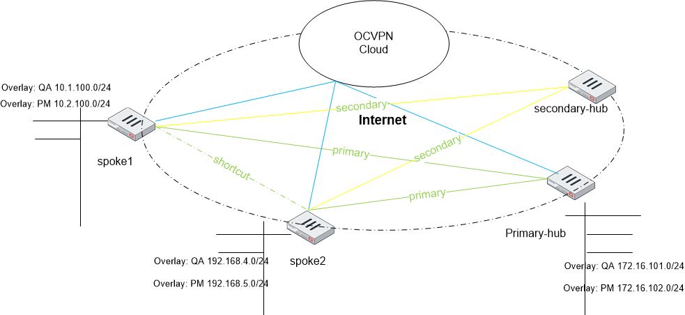

Sample topology

The steps below use the following overlays and subnets for the sample configuration:
- Primary hub:
- Overlay name: QA. Local subnets: 172.16.101.0/24
- Overlay name: PM. Local subnets: 172.16.102.0/24
- Secondary hub:
- Overlays are synced from primary hub.
- Spoke1:
- Overlay name: QA. Local subnets: 10.1.100.0/24
- Overlay name: PM. Local subnets: 10.2.100.0/24
- Spoke2:
- Overlay name: QA. Local interfaces: lan1
- Overlay name: PM. Local interfaces: lan2
The overlay names on each device must be the same for local and remote selector pairs to be negotiated. |

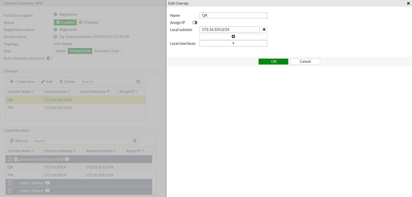

- Configure the OCVPN primary hub by setting the following options:
- For Status, click Enabled.
- For Role, click Primary Hub.
- In the Overlays section, click Create New to create a network overlay.
- Specify the Name, Local subnets, and/or Local interfaces. Then click OK.
- Click Apply to commit the configuration.

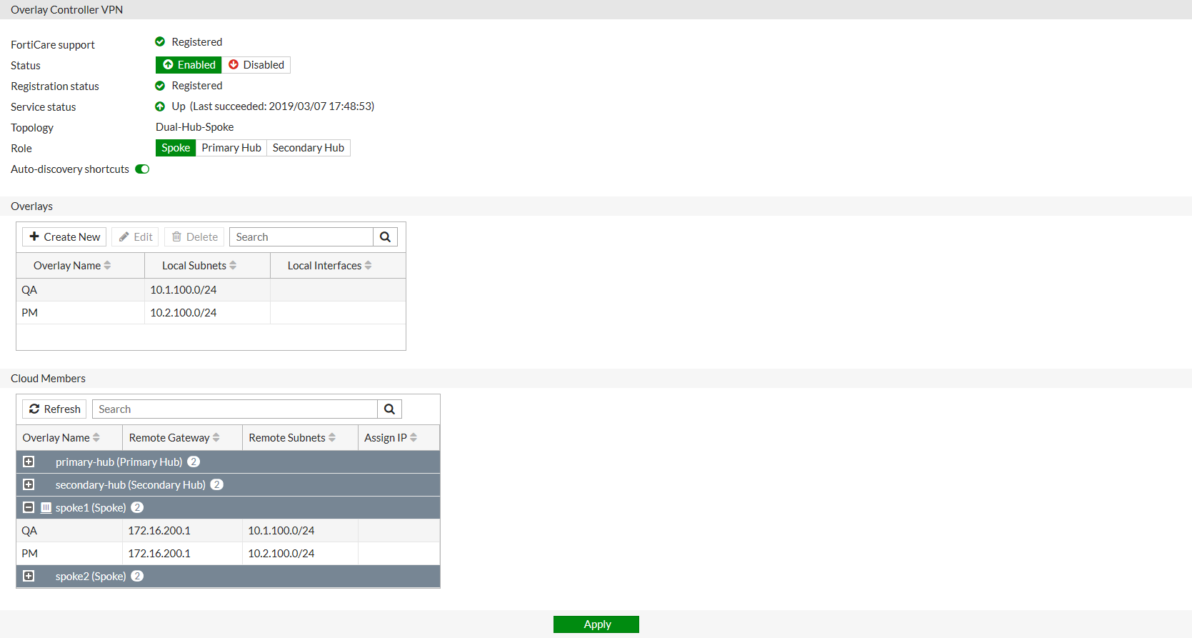

- Configure the OCVPN spokes:
- In the Overlay Controller VPN pane, select Spoke for the Role.
The local subnet must be routable and interfaces must have IP addresses. - Click OK and then click Apply to commit the configuration.
