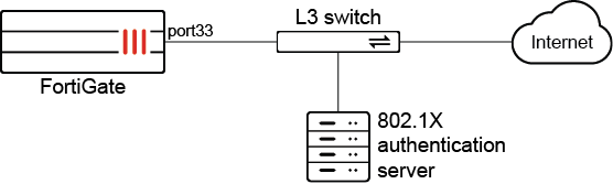

In this example, the FortiGate connects to an L3 switch that is not physically secured. All devices that connect to the internet through the L3 switch must be authenticated with 802.1X on the switch port by either a username and password (PEAP), or a user certificate (TLS). Configuration examples for both EAP authentication methods on port33 are shown.
