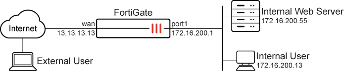

Hairpin NAT, also known as NAT loopback or U-turn NAT, allows devices on the same internal network to communicate using their external IP addresses. This simplifies network configurations and enhances connectivity.
How hairpin NAT works:
Request initiation: An employee within the office network attempts to access an internal resource using its external IP address.
NAT processing: The request is sent to the FortiGate, which recognizes that the destination IP address is its own external IP on the WAN interface.
Hairpin NAT: The FortiGate redirects the request back into the internal network, forwarding it to the web server’s internal IP address and allowing the employee to access the internal web server using the external address.
Example
This configuration allows both internal and remote employees to use the same domain name to access the server, such as www.pochiya.com. Hairpin NAT ensures consistency, avoiding confusion and complications in network configurations. This setup is particularly useful for companies that save bookmarks to internal web servers using public domain names in users’ profiles, ensuring access whether connected to the internal LAN or the internet.
In this scenario, the user can access saved bookmarks containing public domain names from both their office computer on the internal network and their personal computer over the internet.
Before continuing, make sure that the port1 and wan interfaces have been configured with valid IP addresses and some publicly accessible domain names are saved as bookmarks in the user profile.
It is assumed that you have administrative access, the FortiGate is incorporated into your network, and the external IP address is the same as the FortiGate wan interface.
The configuration has four steps:
Create a VIP: Map the external IP address to the internal IP address.
Create a firewall policy for DNAT: Attach the VIP to a firewall policy, allowing external users to access the internal server using the external IP address. See Static virtual IPs for more information.
Create a firewall policy for SNAT: Allow internal users to access the external servers using the external IP address. See Static SNAT for more information.
Verify the result: Confirm that the employee can access the internal web server using the external address.
