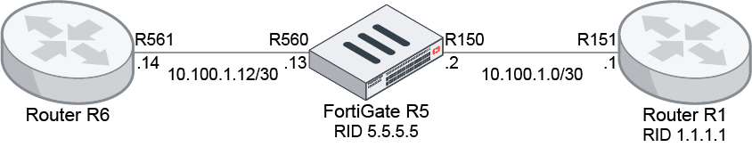

Static route tags
When a static route is configured with a route tag, it is matched in the route map, and then used to set the route's metric and advertise to the BGP neighbor. In the following example, route tag 565 is used, and router R1 receives the advertised route from the FortiGate router R5.
To configure the FortiGate:
Configure the static route:
config router static edit 1 set dst 77.7.7.7 255.255.255.255 set distance 2 set device "R560" set tag 565 next end -
Configure the route map:
config router route-map edit "map1" config rule edit 2 set match-tag 565 set set-metric 2301 next end next end -
Configure the BGP neighbor:
config router bgp config neighbor edit "10.100.1.2" set route-map-out "map1" next end endOn its neighbor side, router R1 receives the advertised route from the FortiGate router R5.
Verify the BGP routing table:
# get router info routing-table bgp Routing table for VRF=0 B 77.7.7.7/32 [20/2301] via 10.100.1.1 (recursive is directly connected, R150), 03:18:53, [1/0]
Verify the network community:
# get router info bgp network 77.7.7.7/32 VRF 0 BGP routing table entry for 77.7.7.7/32 Paths: (1 available, best #1, table Default-IP-Routing-Table) Advertised to non peer-group peers: 2.2.2.2 3.3.3.3 10.100.1.5 2000::2:2:2:2 Original VRF 0 20 10.100.1.1 from 10.100.1.1 (5.5.5.5) Origin incomplete metric 2301, localpref 200, valid, external, best Last update: Wed Oct 5 16:48:28 2022
