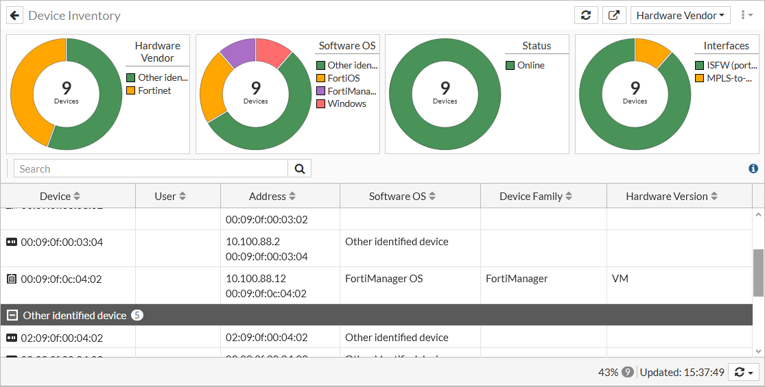

Device detection is intended for devices directly connected to your LAN and DMZ ports. Since the IoT detection service relies on device detection, the device must be on the same Layer 2 network as the FortiGate.
To view the latest device information in the GUI, go to Dashboard > Users & Devices and expand the Device Inventory widget.

  1. Enable Device Detection on an interface.
  2. FortiGate uses the interface to detect device traffic flow.
  3. Upon detecting traffic from an unknown device, FortiGate sends the device data to the FortiGuard collection server.
  4. The collection server returns data about the new device to the FortiGuard query server.
  5. If the device signature does not appear in the local Device Database (CIDB) or some fields are not complete, FortiGate queries FortiGuard for more information about the device.
