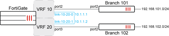

Route leaking allows you to configure communication between VRFs. If route leaking is not configured, then the VRFs are isolated. This example shows route leaking with BGP using virtual inter-VDOM links.
In this example, a hub FortiGate forms BGP neighbors with two branches. It learns the networks 192.168.101.0/24 and 192.168.102.0/24 from the neighbors and separates them into VRF 10 and VRF 20.
To leak the learned routes to each other, an inter-VDOM link (IVL) is formed. An IVL normally bridges two VDOMs, but in this case the links reside on the same VDOM and are used to bridge the two VRFs. NPU inter-VDOM links could also be used on models that support it to deliver better performance.

VRF 10 has a leaked route to 192.168.102.0/24 on IVL link-10-20-0, and VRF 20 has a leaked route to 192.168.101.0/24 on IVL link-10-20-1,

  1. Allow interface subnets to use overlapping IP addresses:
    config system settings
        set allow-subnet-overlap enable
  2. Configure the inter-VDOM links:
    config system vdom-link
        edit link-10-20-
  3. Configure the interface settings:
    config system interface
        edit link-10-20-0
            set vdom "root"
            set vrf 10
            set ip 10.1.1.1/30
        edit link-10-20-1
            set vdom "root"
            set vrf 20
            set ip 10.1.1.2/30
