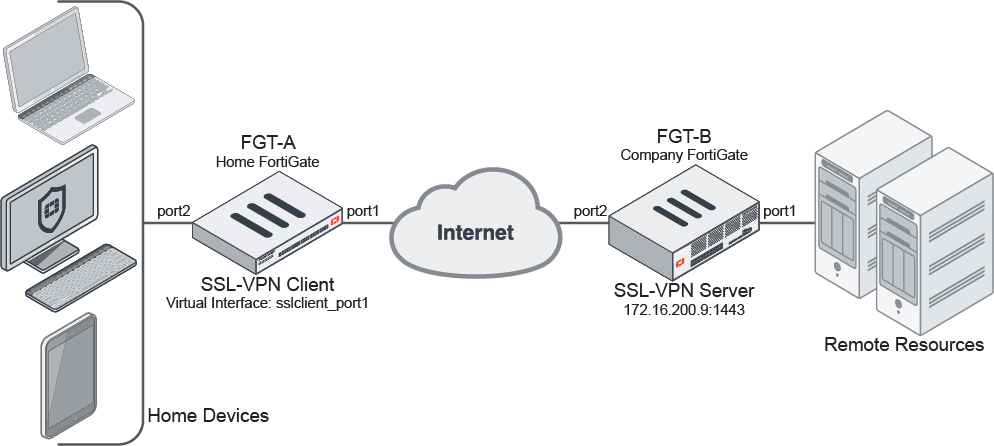

Example
In this example, the home FortiGate (FGT-A) is configured as an SSL VPN client, and the company FortiGate (FGT-B) is configured as an SSL VPN server. After FGT-A connects to FGT-B, the devices that are connected to FGT-A can access the resources behind FGT-B.
The SSL VPN server has a custom server certificate defined, and the SSL VPN client user uses PSK and a PKI client certificate to authenticate. The FortiGates must have the proper CA certificate installed to verify the certificate chain to the root CA that signed the certificate.
Split tunneling is used so that only the destination addresses defined in the server's firewall policies are routed to the server, and all other traffic is connected directly to the internet.

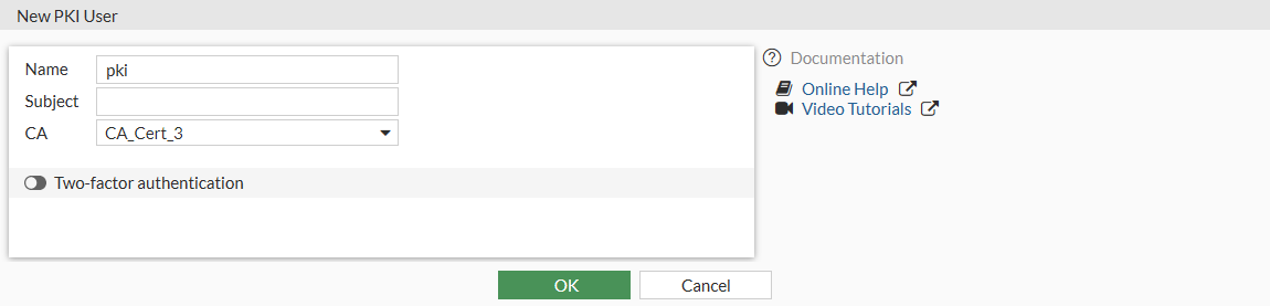

To create a PKI user in the GUI:
The PKI menu is only available in the GUI after a PKI user has been created using the CLI, and a CN can only be configured in the CLI. |
Go to User & Authentication > PKI and click Create New.
Set the Name to pki.
Set CA to the CA certificate that is used to verify the client certificate.
Click OK.
In the CLI, specify the CN that must be matched. If no CN is specified, then any certificate that is signed by the CA will be valid and matched.
