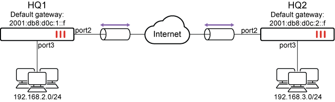

In this example, two private networks with IPv4 addressing communicate securely over IPv6 infrastructure.
The following topology is used for this example:
Port2 connects to the IPv6 public network and port3 connects to the IPv4 local network.
HQ1 port2 IPv6 address is 2001:db8:d0c:1::e and port3 IPv4 address is 192.168.2.1.
HQ2 port2 IPv6 address is 2001:db8:d0c:2::e and port3 IPv4 address is 192.168.3.1.
