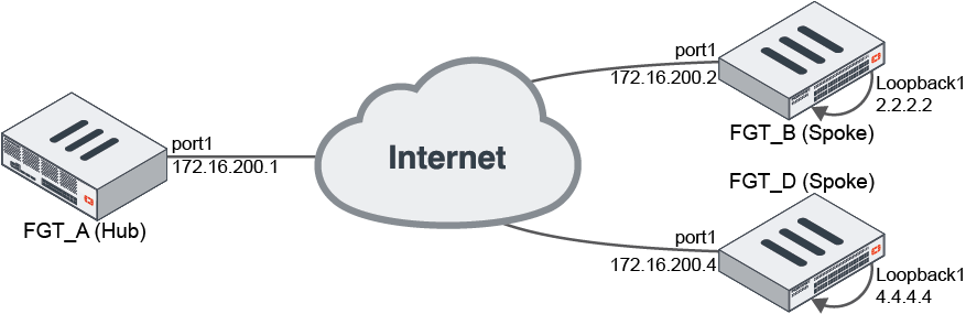

In this example, the hub is configured as a VPN dial-up server and both of the spokes are connected to the hub. It is assumed that the VPN configuration is already done, with a dynamic gateway type and kernel device creation (net-device) disabled. Only one SD-WAN interface is used, so there is only one VPN overlay member in the SD-WAN zone. Multiple WAN interfaces and VPN overlays could be used.
The VPN interfaces and IP addresses are:
FortiGate |
Interface |
IP Address |
FGT_A (Hub) |
hub-phase1 |
10.10.100.254 |
FGT_B (Spoke) |
spoke11-p1 |
10.10.100.2 |
FGT_D (Spoke) |
spoke21-p1 |
10.10.100.3 |
The hub VPN has two child tunnels, one to each spoke.
The speed test configuration is shown in Running speed tests from the hub to the spokes in dial-up IPsec tunnels. This example shows applying a shaping profile to the hub's tunnel interface in order to apply interface based traffic shaping to the child tunnels.
