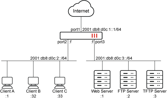

Topology
The following topology is used for this example:
The company is assigned the site prefix of 2001:db8:d0c::/48 by their ISP.
The IPv6 address for the Web Server is 2001:db8:d0c:3::1/64.
The IPv6 address for the FTP Server is 2001:db8:d0c:3::2/64.
The IPv6 address for the TFTP Server is 2001:db8:d0c:3::3/64.
The range on the internal IPv6 network that can access both servers is from 2001:db8:d0c:2::1 to 2001:db8:d0c:2::32.
The IPv6 address of port1 is 2001:db8:d0c:1::1/64.
The IPv6 address of port2 is 2001:db8:d0c:2::f/64.
The IPv6 address of port3 is 2001:db8:d0c:3::f/64.
The IPv6 address of the default gateway is 2001:db8:d0c:1::f/64.
