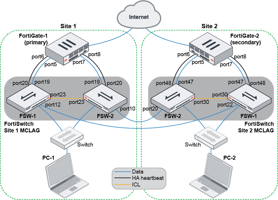

This example shows how to configure heartbeat VLANs to assign to the access ports that the heartbeat interfaces connect to, passing over the trunk between the FortiSwitches on the two sites.
FortiGate HA is with two FortiGates in separate locations and the switch layer connection between the FortiSwitches is used for the heartbeat signal.

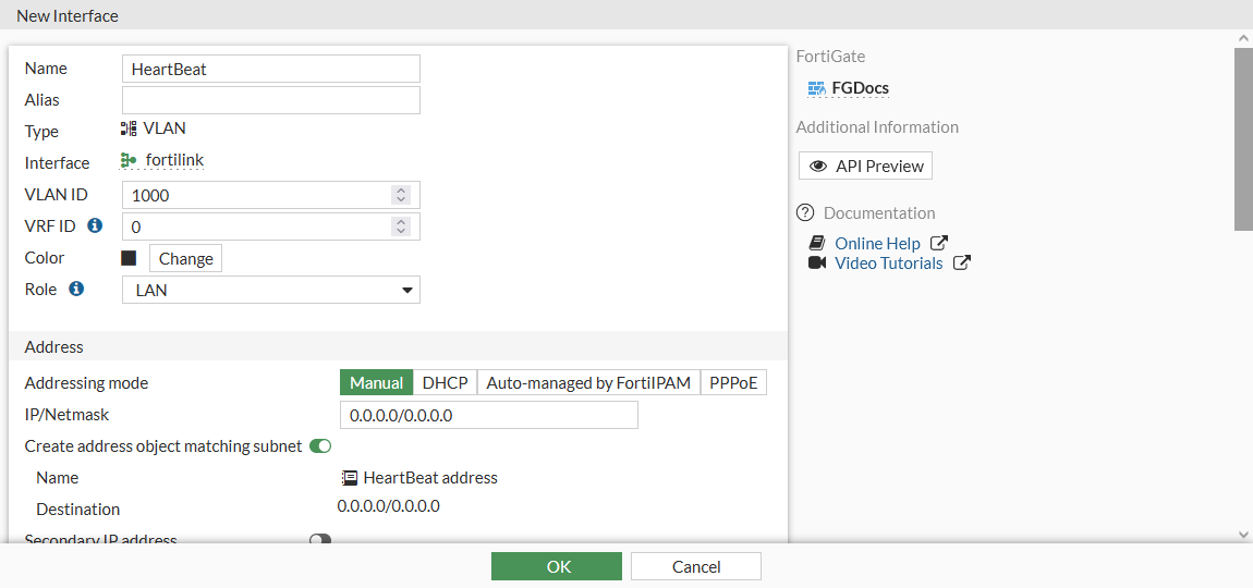

Go to WiFi & Switch Controller > FortiSwitch VLANs and create switch VLANs that are dedicated to each FortiGate HA heartbeat interface between the two FortiGates: Heartbeat VLAN 1000 and Heartbeat VLAN 1100.
Assign the native VLAN of the switch ports that are connected to the heartbeat ports to the created VLAN. Each HA heartbeat should be in its own VLAN.

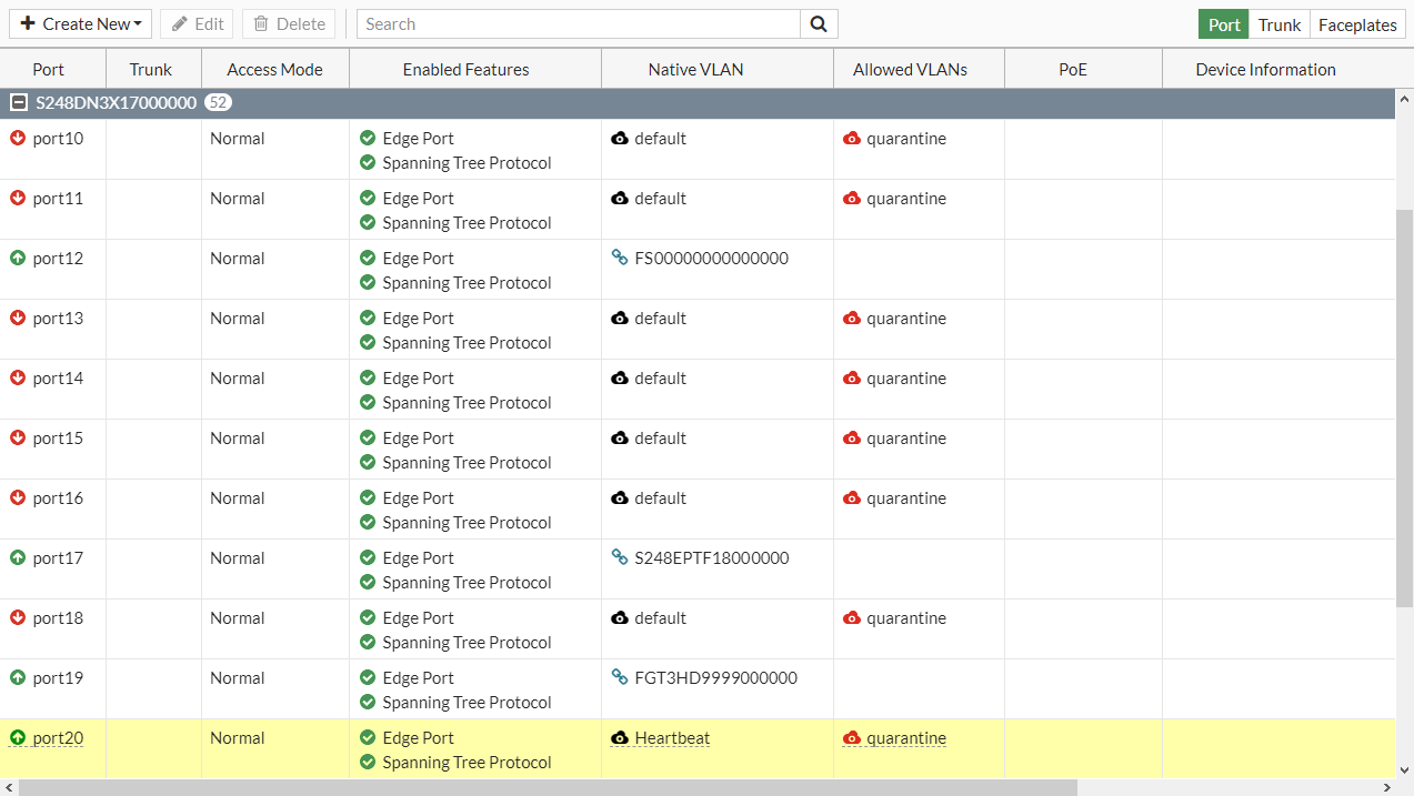

Go to WiFi & Switch Controller > FortiSwitch Ports.
In the Native VLAN column for the heartbeat port that is connected to FSW-1, click the edit icon and select the Heartbeat VLAN.
In the Native VLAN column for the heartbeat port that is connected to FSW-2, click the edit icon and select the Heartbeat2 VLAN.

Connect cables between the FortiSwitch MCLAG in Site 1 and Site 2:
Connect a cable from Site 1 FSW-1 port 12 to Site 2 FSW-1 port 22.
Connect a cable from Site 1 FSW-2 port 10 to Site 2 FSW-2 port 20.
