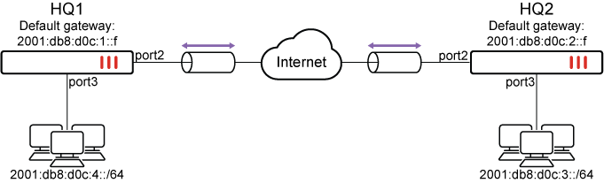

The following topology is used for this example:
Port2 connects to the public network and port3 connects to the local network.
The IPv6 address for HQ1 port2 and port3 is 2001:db8:d0c:1::e and 2001:db8:d0c:4::e, respectively.
The IPv6 address for HQ2 port2 and port3 is 2001:db8:d0c:2::e and 2001:db8:d0c:3::e, respectively.
Please note that the IPv6 addresses used in this example are for illustrative purposes only and should not be used in your environment. The 2001:db8::/32 prefix is a special IPv6 prefix designated for use in documentation examples. See RFC 3849 for more information. |
