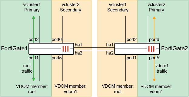

Active-passive virtual clustering uses VDOM partitioning to send traffic for some VDOMs to the primary FortiGate and traffic for other VDOMs to the secondary FortiGates. Traffic distribution between FortiGates can potentially improve throughput. If a failure occurs and only one FortiGate continues to operate, all traffic fails over to that FortiGate, similar to normal HA. If the failed FortiGates rejoin the cluster, the configured traffic distribution is restored.
In an active-passive virtual cluster of two FortiGates, the first and second FortiGates share traffic processing according to the VDOM partitioning configuration. The following is an example of two virtual clusters, with each member acting as primary for different vclusters.
If you add a third or fourth FortiGate, the first and second FortiGates process all traffic and the other one or two FortiGates operate in standby mode. If the first or second FortiGate fails, one of the other FortiGates becomes the new primary or secondary FortiGate and begins processing traffic.
For better load balancing, it is recommended to have as many vclusters as there are HA members. This way, each HA member can be a primary unit for each cluster, thereby processing traffic while standing by for the other vcluster as secondary. The following is an example of four FortiGates in an FGCP cluster, with four vclusters and four VDOMs. Each FortiGate is the primary unit for a vcluster and actively processes traffic as the primary member.

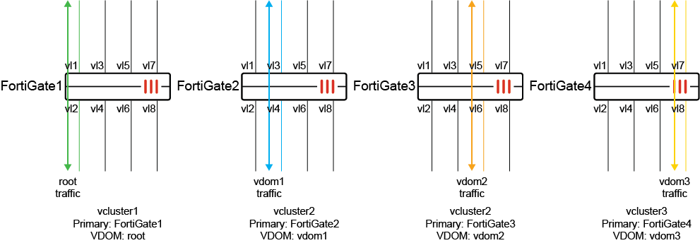

Support up to 30 virtual clusters
FortiOS supports up to 30 virtual clusters, which allows more VDOMs to be spread across different virtual clusters without overlapping. Each virtual cluster supports its own failover conditions. Prior to 7.2.0, only two virtual clusters were supported.

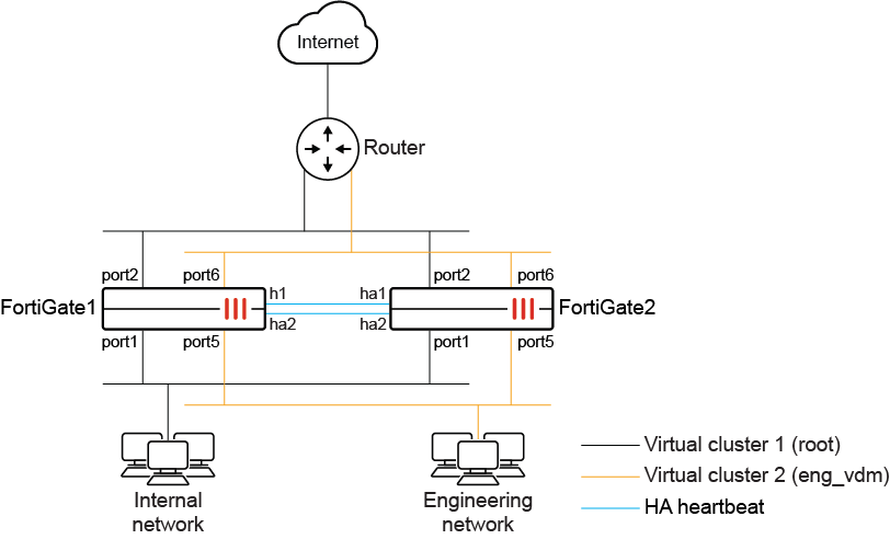

This example shows a virtual cluster configuration consisting of two FortiGates. The virtual cluster has two VDOMs, root and eng_vdm.
The root VDOM can only be associated with virtual cluster 1.
The VDOM that is assigned as the management VDOM can also only be associated with virtual cluster 1.

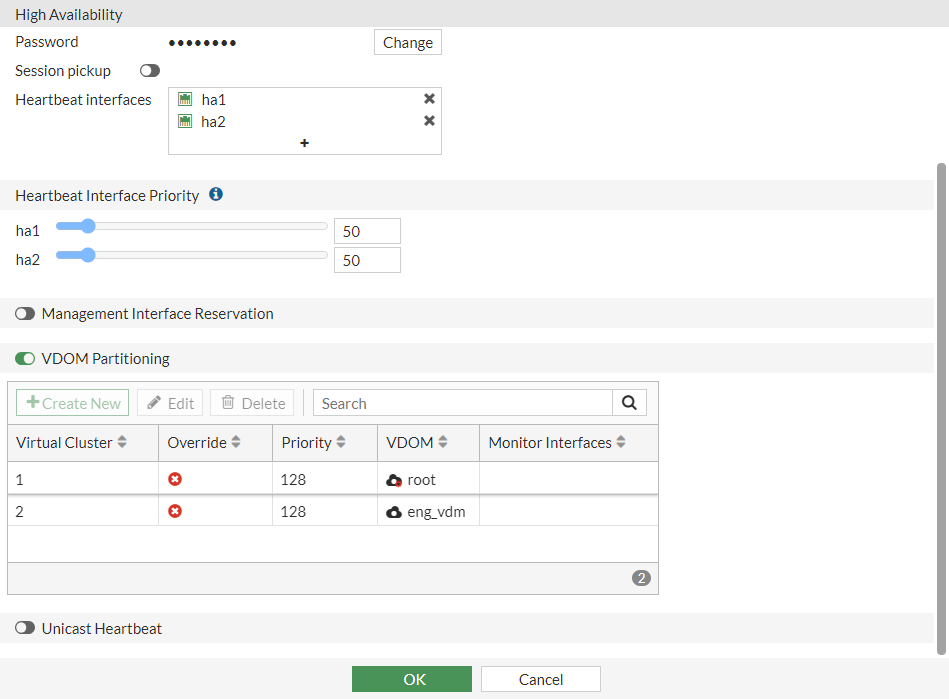

  7. Implement a virtual cluster by moving the new VDOM to virtual cluster 2:
    1. Go to System > HA and enable VDOM Partitioning.
    2. In the table, click Create New. The New Virtual Cluster pane opens.
    3. Click the + and add the eng_vdm VDOM.
    4. Click OK to save the virtual cluster.
    5. Click OK to save the HA configuration.

To configure multiple virtual clusters in the GUI:
  2. Create a virtual cluster:
    1. In the table, click Create New. The New Virtual Cluster pane opens.
    2. Set the Device priority to 200.
    3. Click the + and add the Virtual domains.
    4. Optionally, click the + and add the Monitor interfaces.
    5. Click OK.
  3. Repeat step 2 to create the remaining virtual clusters.
  4. Click OK to save the HA configuration. The HA page summary displays the multiple virtual clusters, each with a Primary and Secondary HA member.
  5. Edit the priority settings for the secondary members to be 100:
    1. Select the Secondary member in the table, and click Edit.
    2. Set the Priority to 100.
    3. Click OK.
  6. Repeat step 5 for the remaining secondary members.
