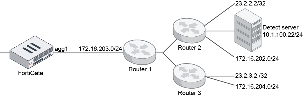

Example
In this example, the FortiGate has several routes to 23.2.2.2/32 and 172.16.202.2/24, and is monitoring the link agg1 by pinging the server at 10.1.100.22. The link monitor uses the gateway 172.16.203.2.
When the link monitor fails, only the routes to the specified subnet using interface agg1 and gateway 172.16.203.2 are removed.
