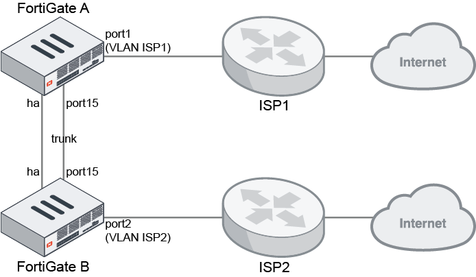

Example 1: HA using a VLAN switch
In this example, two FortiGates in an HA cluster are connected to two ISP routers. Instead of connecting to external L2 switches, each FortiGate connects to each ISP router on the same hardware switch port on the same VLAN. A trunk port connects the two FortiGates to deliver the 802.1Q tagged traffic to the other. A full mesh between the FortiGate cluster and the ISP routers is achieved where no single point of failure will cause traffic disruptions.
This example assumes that the HA settings are already configured. The interface and VLAN switch settings are identical between cluster members and synchronized. See HA using a hardware switch to replace a physical switch for a similar example that does not use a VLAN switch.
To configure the VLAN switches:
  1. Configure the ISP interfaces with the corresponding VLAN IDs:
    config system virtual-switch
        edit "ISP1"
            set physical-switch "sw0"
            set vlan 2951
            config port
                edit "port1"
        edit "ISP2"
            set vlan 2952
            config port
                edit "port2"
  2. Configure the VLAN switch interface addressing:
    config system interface
        edit "ISP1"
            set vdom "root"
            set ip 192.168.10.99 255.255.255.0
            set allowaccess ping
            set type hard-switch
        edit "ISP2"
            set vdom "root"
            set ip 192.168.20.99 255.255.255.0
  3. Designate port15 as the trunk port:
        edit port15
            set trunk enable
  4. Configure firewall policies to allow outgoing traffic on the ISP1 and ISP2 interfaces:
    config firewall policy
            set srcintf "port11"
            set dstintf "ISP1"
            set srcaddr "all"
            set dstaddr "all"
            set service "ALL"
            set nat enable
            set dstintf "ISP2"
            set srcaddr "all"
            set dstaddr "all"
            set service "ALL"
            set nat enable

  1. Connect a PC to internal1 on FortiGate B.
  2. Verify that it receives an IP address from FortiGate A’s DHCP server.
  3. From the PC, ping FortiGate B on 192.168.10.99.
  4. Ping FortiGate A on 192.168.10.98.
  5. Connect to the internet. Traffic is allowed by the VLAN10-out policy.
