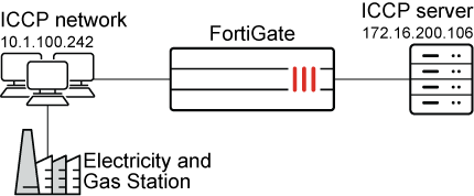

IEC 61850 is a SCADA protocol whose services are mapped to a number of protocols, including MMS services. MMS/ICCP detection is supported in IPS. The purpose of the MMS dissectors is to identify every IEC 61850 service to distinguish different MMS/ICCP messages. IPS engine 6.0.12 and later support MMS dissectors.
The following scenarios are also supported:
  • Multiple MMS PDUs are transferred in one TCP payload, and the IPS engine identifies individuals.
  • An MMS message is split over multiple TCP segments, where MMS runs over COTP segments.
  • ICCP/TASE.2 that also uses MMS transport (ISO transport over TCP for ICCP) is detected.
OT signatures must be enabled in the global IPS settings to receive MMS/ICCP signatures. By default, OT signatures are excluded.

Diagnose command
The COTP dissector adds support for identifying every MMS PDU, and let the IPS engine separate them, like the Modbus and IEC-104 services for example.

MMS dissectors can be triggered, and MMS/ICCP signatures can be monitored and logged.
Log samples:
date=2020-03-26 time=15:51:10 logid="1059028704" type="utm" subtype="app-ctrl" eventtype="signature" level="information" vd="vd1" eventtime=1585263070836106492 tz="-0700" appid=43699 srcip=10.1.100.242 dstip=172.16.200.106 srcport=50963 dstport=102 srcintf="port13" srcintfrole="undefined" dstintf="port14" dstintfrole="undefined" proto=6 service="tcp/26112" direction="outgoing" policyid=1 sessionid=2711 applist="test" action="pass" appcat="Operational.Technology" app="MMS_Read.Request" incidentserialno=376610508 msg="Operational.Technology: MMS_Read.Request," apprisk="elevated"
date=2020-03-26 time=16:15:45 logid="1059028704" type="utm" subtype="app-ctrl" eventtype="signature" level="information" vd="vd1" eventtime=1585091746264983273 tz="-0700" appid=44684 srcip=10.1.100.242 dstip=172.16.200.106 srcport=41665 dstport=102 srcintf="port13" srcintfrole="undefined" dstintf="port14" dstintfrole="undefined" proto=6 service="tcp/26112" direction="incoming" policyid=1 sessionid=194463 applist="test" action="pass" appcat="Operational.Technology" app="ICCP_Transfer.Reporting" incidentserialno=762763993 msg="Operational.Technology: ICCP_Transfer.Reporting," apprisk="elevated"
