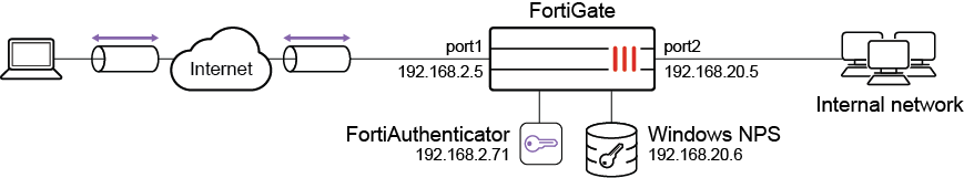

Sample topology

In this example, you will use a Windows NPS server as the Primary server and a FortiAuthenticator as the Secondary server. It is assumed that users are synchronized between the two servers.

User radkeith is a member of both the NPS server and the FAC server.
When the Primary server is up, the user successfully connects to Agentless VPN.
# diagnose sniffer packet any 'port 1812' 4 0 l interfaces=[any] filters=[port 1812] 2020-05-15 16:26:50.838453 port3 out 192.168.20.5.2374 -> 192.168.20.6.1812: udp 118 2020-05-15 16:26:50.883166 port3 in 192.168.20.6.1812 -> 192.168.20.5.2374: udp 20 2020-05-15 16:26:50.883374 port3 out 192.168.20.5.2374 -> 192.168.20.6.1812: udp 182 2020-05-15 16:26:50.884683 port3 in 192.168.20.6.1812 -> 192.168.20.5.2374: udp 228
The access request is sent to the Primary NPS server 192.168.20.6, and the connection is successful.
# get vpn ssl monitor Agentless VPN Login Users: Index User Group Auth Type Timeout From HTTP in/out HTTPS in/out 0 radkeith PrimarySecondaryGroup 2(1) 285 192.168.2.202 0/0 0/0 Agentless VPN sessions: Index User Group Source IP Duration I/O Bytes Tunnel/Dest IP
When the Primary server is down, and the Secondary server is up, the user successfully connects to Agentless VPN again:
# diagnose sniffer packet any 'port 1812' 4 0 l interfaces=[any] filters=[port 1812] 2020-05-15 16:31:23.016875 port3 out 192.168.20.5.7989 -> 192.168.20.6.1812: udp 118 2020-05-15 16:31:28.019470 port3 out 192.168.20.5.7989 -> 192.168.20.6.1812: udp 118 2020-05-15 16:31:30.011874 port1 out 192.168.2.5.23848 -> 192.168.2.71.1812: udp 118 2020-05-15 16:31:30.087564 port1 in 192.168.2.71.1812 -> 192.168.2.5.23848: udp 20
Access request is sent to the Primary NPS server 192.168.20.6, but there was no response. RADIUS authentication falls through to the Secondary FortiAuthenticator 192.168.2.71, and the authentication was accepted. The Agentless VPN connection is established.
# get vpn ssl monitor Agentless VPN Login Users: Index User Group Auth Type Timeout From HTTP in/out HTTPS in/out 0 radkeith PrimarySecondaryGroup 2(1) 287 192.168.2.202 0/0 0/0 Agentless VPN sessions: Index User Group Source IP Duration I/O Bytes Tunnel/Dest IP

Access is denied by the NPS server because the user does not exist. However, access is accepted by FortiAuthenticator. The end result is the authentication is successful.
# get vpn ssl monitor Agentless VPN Login Users: Index User Group Auth Type Timeout From HTTP in/out HTTPS in/out 0 fackeith dualPrimaryGroup 2(1) 292 192.168.2.202 0/0 0/0 Agentless VPN sessions: Index User Group Source IP Duration I/O Bytes Tunnel/Dest IP
Case 2: Connect to the Agentless VPN web portal using a web browser and authenticate with user radkeith:
# diagnose sniffer packet any 'port 1812' 4 0 l interfaces=[any] filters=[port 1812] 2020-05-15 17:26:07.335791 port1 out 192.168.2.5.17988 -> 192.168.2.71.1812: udp 118 2020-05-15 17:26:07.335911 port3 out 192.168.20.5.17988 -> 192.168.20.6.1812: udp 118 2020-05-15 17:26:07.337659 port3 in 192.168.20.6.1812 -> 192.168.20.5.17988: udp 20 <--access-accept 2020-05-15 17:26:07.337914 port3 out 192.168.20.5.17988 -> 192.168.20.6.1812: udp 182 2020-05-15 17:26:07.339451 port3 in 192.168.20.6.1812 -> 192.168.20.5.17988: udp 228 2020-05-15 17:26:08.352597 port1 in 192.168.2.71.1812 -> 192.168.2.5.17988: udp 20 <--access-reject
There is a password mismatch for this user on the Secondary RADIUS server. However, even though the authentication was rejected by FortiAuthenticator, it was accepted by Windows NPS. Therefore, the end result is authentication successful.
# get vpn ssl monitor Agentless VPN Login Users: Index User Group Auth Type Timeout From HTTP in/out HTTPS in/out 0 radkeith dualPrimaryGroup 2(1) 290 192.168.2.202 0/0 0/0 Agentless VPN sessions: Index User Group Source IP Duration I/O Bytes Tunnel/Dest IP
