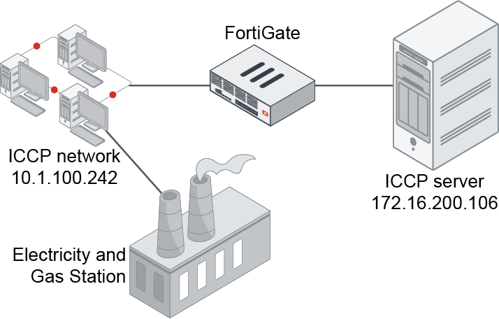

MMS dissectors can be triggered, and MMS/ICCP signatures can be monitored and logged.
Log samples:
date=2020-03-26 time=15:51:10 logid="1059028704" type="utm" subtype="app-ctrl" eventtype="signature" level="information" vd="vd1" eventtime=1585263070836106492 tz="-0700" appid=43699 srcip=10.1.100.242 dstip=172.16.200.106 srcport=50963 dstport=102 srcintf="port13" srcintfrole="undefined" dstintf="port14" dstintfrole="undefined" proto=6 service="tcp/26112" direction="outgoing" policyid=1 sessionid=2711 applist="test" action="pass" appcat="Operational.Technology" app="MMS_Read.Request" incidentserialno=376610508 msg="Operational.Technology: MMS_Read.Request," apprisk="elevated"
date=2020-03-26 time=16:15:45 logid="1059028704" type="utm" subtype="app-ctrl" eventtype="signature" level="information" vd="vd1" eventtime=1585091746264983273 tz="-0700" appid=44684 srcip=10.1.100.242 dstip=172.16.200.106 srcport=41665 dstport=102 srcintf="port13" srcintfrole="undefined" dstintf="port14" dstintfrole="undefined" proto=6 service="tcp/26112" direction="incoming" policyid=1 sessionid=194463 applist="test" action="pass" appcat="Operational.Technology" app="ICCP_Transfer.Reporting" incidentserialno=762763993 msg="Operational.Technology: ICCP_Transfer.Reporting," apprisk="elevated"
