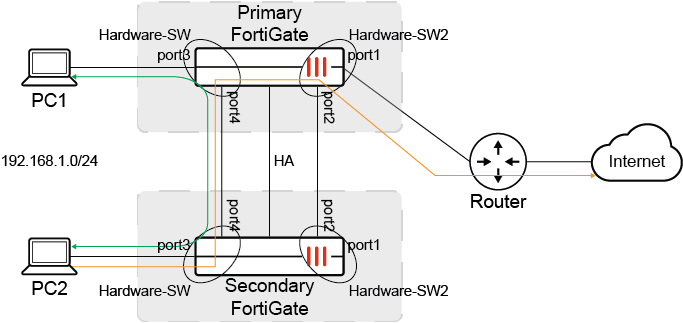

The examples use the following topology:
Traffic between hardware switches
When using Hardware switch in HA environment, a client device connected to the hardware switch on the primary FortiGate can communicate with client devices connected to the hardware switch on secondary FortiGates as long as there is a direct connection between the two switches.

    After configuring the hardware switches, PC1 and PC2 can now communicate with each other.
Traffic passes through FortiGate
If client device needs to send traffic through the FortiGate, additional firewall configuration on the FortiGate is required.
All traffic from the hardware switches on either the primary or secondary FortiGate reaches the primary FortiGate first. The traffic is then directed according to the HA mode and firewall configuration.
On the WAN side, in order for both HA members to reach the upstream router without connecting to a switch, a hardware switch must be configured with a direct connection between the cluster members.

    Traffic from PC1 and PC2 can now reach destinations outside of the FortiGate cluster.
