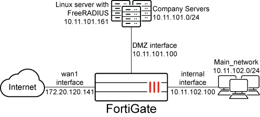

A common RADIUS SSO (RSSO) topology involves a medium-sized company network of users connecting to the Internet through the FortiGate and authenticating with a RADIUS server. The following describes how to configure FortiOS for this scenario. The example makes the following assumptions:

Configuring this example consists of the following steps:
  1. Configure RADIUS.
  2. Configure FortiGate interfaces.
  3. Configure a RSSO agent.
  4. Create a RSSO user group.
  5. Configure security policies.
  6. Test the configuration.

To configure FortiGate interfaces:
You must define a DHCP server for the internal network, as this network type typically uses DHCP. The wan1 and dmz interfaces are assigned static IP addresses and do not need a DHCP server. The following table shows the FortiGate interfaces used in this example:
Interface Subnet Act as DHCP server Devices
wan1 172.20.120.141 No Internet service provider
dmz 10.11.101.100 No Servers including RADIUS server
internal 10.11.102.100 Yes: x.x.x.110-250 Internal user network

You must configure lists before creating security policies.
Schedule

The following security policy configurations are basic and only include logging and default AV and IPS. These policies allow or deny access to non-RADIUS SSO traffic. These are essential as network services including DNS, NTP, and FortiGuard require access to the Internet.
To configure security policies:
