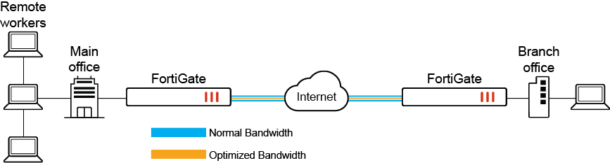

All optimized traffic passes between the FortiGate units over a WAN optimization tunnel. Traffic in the tunnel can be sent in plain text or encrypted. Both plain text and the encrypted tunnels use TCP destination port 7810.
