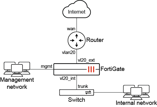

The FortiGate or VDOM operates in layer 2 to forward traffic between network devices such as routers, firewalls, and switches. For example. it can be installed inline between a router and a switch to perform security scanning without changing the network topology or modifying the IP addresses. When you add a FortiGate that is in transparent mode to a network, it only needs to be provided with a management IP address in order to access the device. It is recommended that a dedicated interface is used to connect to the management network in transparent mode.
The following topology is an example of a transparent mode FortiGate inserted inline between a router and a switch:
Using transparent mode VDOMs is recommended when multiple VLANs pass through the FortiGate. Otherwise, they must be separated into different forwarding domains within the same VDOM.
