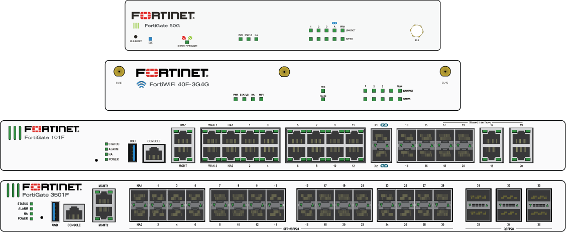

Check your device's QuickStart guide for specific LED information: FortiGate QuickStart Guides.
The following faceplates show examples of where the LEDs are typically found on FortiGate models:
The following tables list the possible LED states and their meanings. Not all devices include every LED or support every state.
