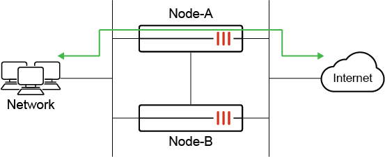

Initially, when you prepare an HA cluster in A-P mode for upgrade, traffic passes through the primary unit (Node-A) as the secondary unit (Node-B) sits on standby.

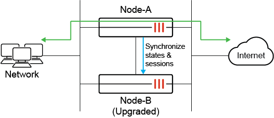

After the upgrade is completed on a secondary unit, states and sessions are synchronized. The members are now operating in MVC mode; however, traffic continues to pass through Node-A.

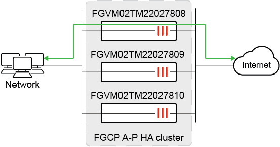

In this example, three HA members are running in an FGCP A-P HA cluster.
The member FGVM02TM22027808 is acting as the primary and forwarding traffic. The member FGVM02TM22027810 is chosen for upgrade.
The cluster is originally running build 2456. The secondary unit is upgraded to build 2461. Fictitious build numbers are used in this example to demonstrate functionality of the feature.
