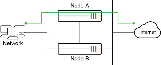

This can apply to any HA clusters with two or more members. Administrators can initiate an upgrade on a secondary member by using its CLI console or accessing the device's GUI from its HA management interface.
Initially, when you prepare an HA cluster in A-P mode for upgrade, traffic passes through the primary unit (Node-A) as the secondary unit (Node-B) sits on standby.

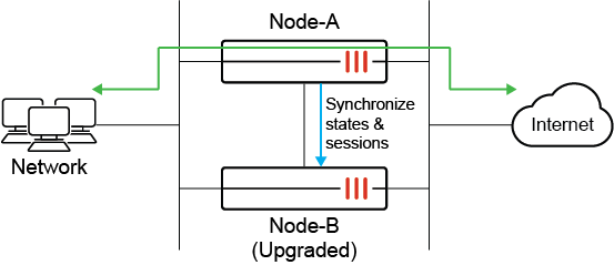

After the upgrade is completed on a secondary unit, states and sessions are synchronized. The members are now operating in MVC mode; however, traffic continues to pass through Node-A.

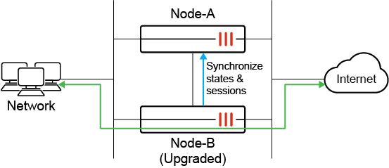

Administrators can manually trigger failover to make Node-B the new primary when ready. This can be done by resetting the HA uptime or changing device priorities, whichever method is desired. Traffic now passes through Node-B.
The upgraded system (Node-B) can be tested to verify that traffic can pass smoothly. If verification fails, administrators can trigger a failover to fail back to Node-A to avoid any downtime.
If verification is successful, administrators can manually trigger an upgrade on Node-A to bring the HA member up to the same version as Node-B to complete the HA upgrade procedure. This can be performed by accessing Node-A’s GUI from its HA management interface or using its CLI console.

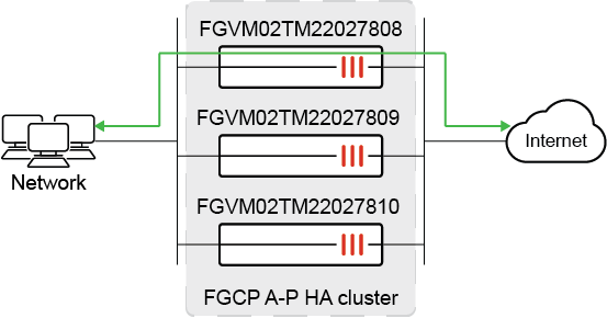

In this example, three HA members are running in an FGCP A-P HA cluster.
The member FGVM02TM22027808 is acting as the primary and forwarding traffic. The member FGVM02TM22027810 is chosen for upgrade.
The cluster is originally running build 2456. The secondary unit is upgraded to build 2461. Fictitious build numbers are used in this example to demonstrate functionality of the feature.

  5. Fail over the HA cluster so that the secondary member, FGVM02TM22027810, becomes the primary. Since override is not enabled and the HA primary is determined by uptime, you can reset the HA uptime on the units that were not upgraded:
    # diagnose sys ha reset-uptime
  6. Once verification on the upgraded member is successful, repeat step 2 to perform upgrades on the remaining units.
Example 2: upgrade multiple secondary members using the secondary-only upgrade option
Using the same topology as example 1, the three HA cluster members are originally running build 2456. Both secondary units are upgraded using the secondary-only upgrade option. Fictitious build numbers are used in this example to demonstrate functionality of the feature.
To configure the HA cluster:
config system ha
    set group-id 260
    set group-name "hagroup"
    set mode a-p
    set hbdev "port3" 0
    set session-pickup enable
    set upgrade-mode secondary-only
To perform the upgrade:
  1. On the primary unit (FGVM02TM22027808), log in to the CLI console.
  2. Execute a TFTP upgrade:
    FGVM02TM22027808 # execute restore image tftp /home/Images/FortiOS/v7.00/images/build2461/FGT_VM64-v7-build2461-FORTINET.out 172.16.100.71
  3. After the upgrade is complete, verify the version running on the secondary members.
    1. Member 1:
      FGVM02TM22027809 # get system status
      Version: FortiGate-VM64 v7.4.1,build2461,230828 (interim)
    2. Member 2:
      FGVM02TM22027810 # get system status
