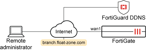

Sample topology
In this example, FortiGuard DDNS is enabled and the DDNS server is set to float-zone.com. Other DDNS server options include fortiddns.com and fortidyndns.com.

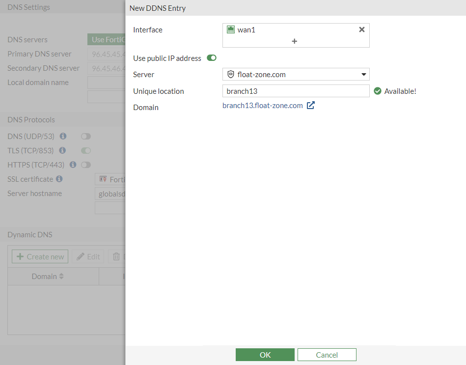

To configure multiple DDNS entries in the GUI:

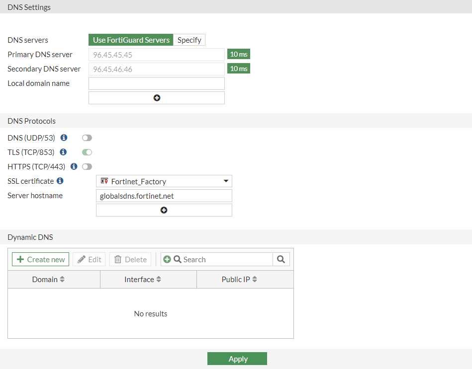

  1. Go to Network > DNS.
  2. In the Dynamic DNS table, click Create new.
    The New DDNS Entry pane opens.
  3. Configure the DDNS entry settings:
    1. Select the Interface with the dynamic connection.
    2. Select the Server that you have an account with.
    3. Enter the Unique Location.
    4. Click OK.
  4. Click Create new and repeat step 3 to add more entries.
  5. Click Apply.
