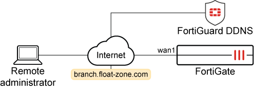

Sample topology
In this example, FortiGuard DDNS is enabled and the DDNS server is set to float-zone.com. Other DDNS server options include fortiddns.com and fortidyndns.com.

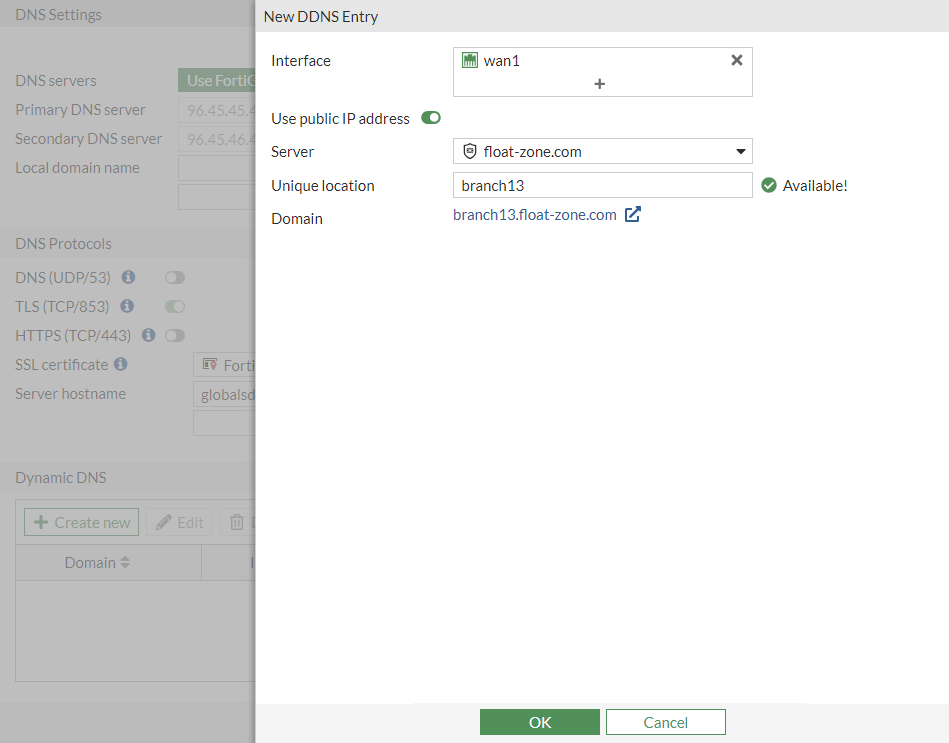

To configure multiple DDNS entries in the GUI:

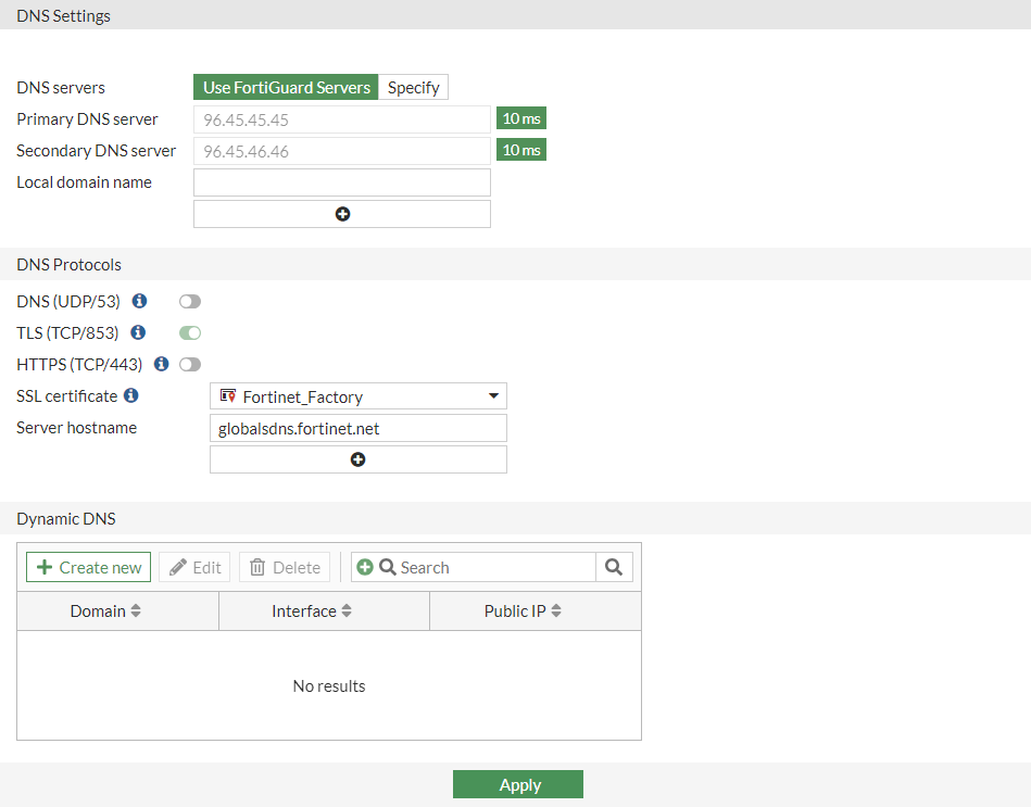

Go to Network > DNS.
In the Dynamic DNS table, click Create new.
The New DDNS Entry pane opens.
Configure the DDNS entry settings:
Select the Interface with the dynamic connection.
Select the Server that you have an account with.
Enter the Unique Location.
Click OK.
Click Create new and repeat step 3 to add more entries.
Click Apply.
