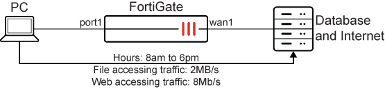

Traffic shaping is accomplished by configuring the outgoing bandwidth and outgoing shaping profile on an interface. The shaping profile uses the outgoing bandwidth of the interface as the maximum link speed, and it only works when the outgoing bandwidth is configured.
This example shows how to apply interface-based traffic shaping to web and file accessing traffic according to a schedule:
  • The link speed of the wan1 interface is 10 Mb/s.
  • File access can use up to 2 Mb/s from 8:00 AM to 6:00 PM.
  • Web access can use 8 Mb/s from 8:00 AM to 6:00 PM.

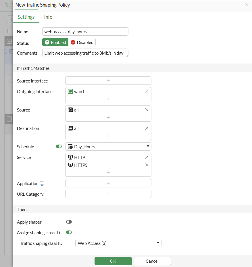

To create a traffic shaping policy and class ID for the web accessing traffic in the GUI:
  1. Go to Policy & Objects > Traffic Shaping, select the Traffic Shaping Policy tab, and click Create New.
  2. Enter a name for the policy, such as web_access_day_hours.
  3. Set Outgoing interface to wan1.
  4. Enable Schedule and select the schedule you just created.
  5. Set Service to web accessing services, such as HTTP and HTTPS.
  6. Enable Assign shaping class ID.
  7. Click the Traffic shaping class ID drop down then click Create.
  8. Enter an integer value for the ID (3) and a description for the Name, such as Web Access.
  9. Click OK.
  10. Select the class ID you just created for Traffic shaping class ID.
  11. Configure the remaining settings as required.
  12. Click OK.

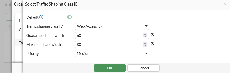

  4. Configure a web accessing traffic shaping class:
    When other types of traffic are competing for bandwidth, this class is guaranteed to 6 Mb/s, or 60% of the bandwidth.
    1. In the Traffic Shaping Classes table click Create New.
    2. Configure the following settings, then click OK:
      Web Access
      Guaranteed bandwidth
      60
      Maximum bandwidth
      80
      Priority
      Medium

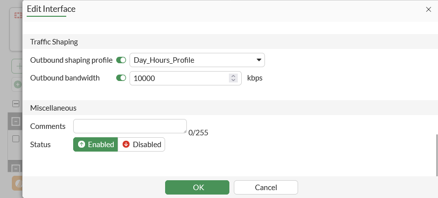

Defining the available bandwidth on an interface
In this example, the link speed of the wan1 interface is 10 Mb/s.
To set the bandwidth of the wan1 interface in the GUI:
  1. Go to Network > Interfaces.
  2. Edit the wan1 interface.
  3. Under Traffic Shaping, enable Outbound shaping profile and select the profile that you just created, Day_Hours_Profile.
  4. Enable Outbound Bandwidth and set it to 10000 Kbps.
  5. Click OK.
  9. Click OK.
  12. Click OK.
      Web Access
      60
      Maximum bandwidth
      80
      Priority
      Medium
  5. Click OK.
