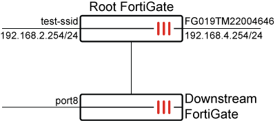

In this example, the FortiGate serves as the Security Fabric root and has two interfaces: test-ssid (vap-switch type) and FG019TM22004646 (lan-extension type). Currently, neither interface has an IP address assigned to it.

    When a downstream FortiGate joins the Security Fabric, port8 is set to a LAN role with no IP address assigned. The IPAM server assigns an IP to port8 of the downstream FortiGate since its role was set to LAN.
