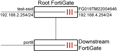

When a downstream FortiGate joins the Security Fabric, port8 is set to a LAN role with no IP address assigned. The IPAM server assigns an IP to port8 of the downstream FortiGate since its role was set to LAN.
Verify the list of IPAM entries in the CLI:
# diagnose sys ipam list entries Entries: (sn, vdom, interface, subnet/mask, conflict) IPAM Entries: FGVM08TM22004645 root FG019TM22004646 192.168.4.254/24 FGVM08TM22004645 root test-ssid 192.168.2.254/24 FGVM08TM22004647 root port8 192.168.3.254/24
