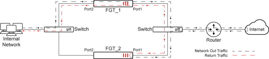

When traffic passes asymmetrically through FGSP peers, UTM inspection can be supported by always forwarding traffic back to the session owner for processing. The session owner is the FortiGate that receives the first packet of the session.
In this example, traffic from the internal network first hits FGT_1, but the return traffic is routed to FGT_2. Consequently, traffic bounces from FGT_2 port1 to FGT_1 port1 using FGT_1’s MAC address. Traffic is then inspected by FGT_1.
This example requires the following settings:
  • The internal and outgoing interfaces of both FortiGates in the FGSP pair are in the same subnet.
  • Both peers have layer 2 access with each other.
Due to the bouncing of traffic back to the session owner, performance degradation is expected.
