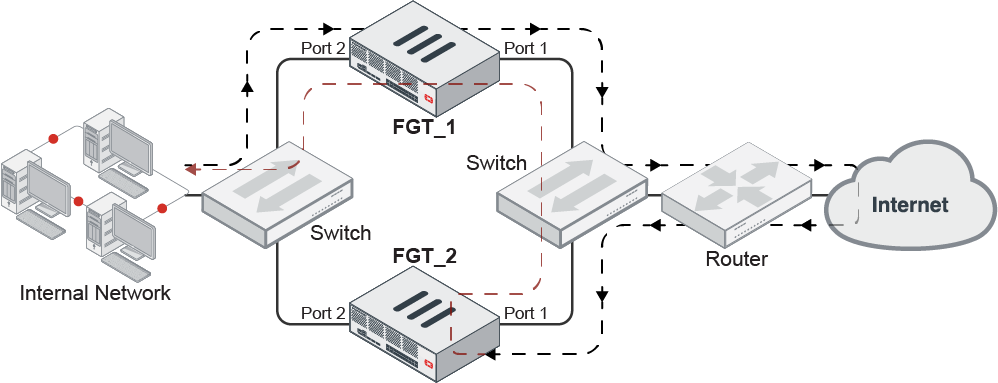

When traffic passes asymmetrically through FGSP peers, UTM inspection can be supported by always forwarding traffic back to the session owner for processing. The session owner is the FortiGate that receives the first packet of the session.
In this example, traffic from the internal network first hits FGT_1, but the return traffic is routed to FGT_2. Consequently, traffic bounces from FGT_2 port1 to FGT_1 port1 using FGT_1’s MAC address. Traffic is then inspected by FGT_1.

Capture packets on FGT_2 to see that traffic bounced from FGT_2 to FGT_1 over the traffic interface.
FGT_2 # diagnose sniffer packet any 'host 10.1.100.15 and host 172.6.200.55' 4 interfaces=[any] filters=[host 10.1.100.15 and host 172.16.200.55] 91.803816 port1 in 172.16.200.55.80 -> 10.1.100.15.40008: syn 2572073713 ack 261949279 92.800480 port1 in 172.16.200.55.80 -> 10.1.100.15.40008: syn 2572073713 ack 261949279 92.800486 port1 out 172.16.200.55.80 -> 10.1.100.15.40008: syn 2572073713 ack 261949279 92.800816 port1 in 172.16.200.55.80 -> 10.1.100.15.40008: syn 2572073713 ack 261949279 92.800818 port1 out 172.16.200.55.80 -> 10.1.100.15.40008: syn 2572073713 ack 261949279
