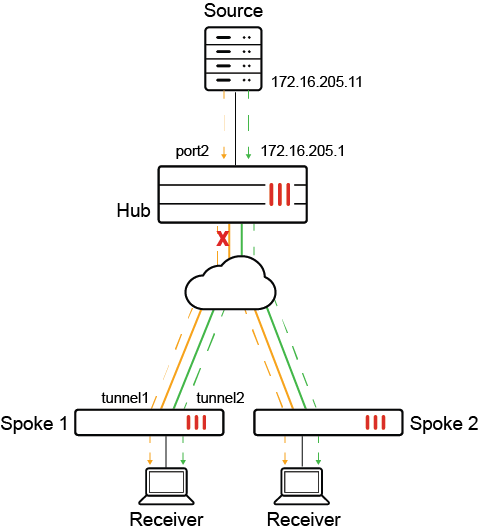

Example 1
In this hub and spoke example for IPv4 multicast traffic, the PIM source is behind the hub FortiGate, and the RP is set to internal port (port2) of the hub firewall. Each spoke connects to the two WAN interfaces on the hub by using an overlay tunnel. The overlay tunnels are members of SD-WAN.
Receivers behind the spoke FortiGates request a stream from the source to receive traffic on tunnel1 by default. When the overlay tunnel goes out of SLA, the multicast traffic fails over to tunnel2 and continues to flow.
Following is an overview of how to configure the topology:
  1. Configure the hub FortiGate in front of the PIM source. The RP is configured on internal port (port2) of the hub FortiGate.
  2. Configure the spoke FortiGates.
  3. Verify traffic failover.

To verify traffic failover:
With this configuration, multicast traffic starts on tunnel1. When tunnel1 becomes out of SLA, traffic switches to tunnel2. When tunnel1 is in SLA again, the traffic switches back to tunnel1.
The following health-check capture on the spokes shows tunnel1 in SLA with packet-loss (1.000%):

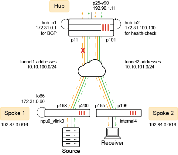

Example 2
In this hub and spoke example for IPv4 multicast traffic, the PIM source is behind spoke 1, and the RP is configured on the hub FortiGate. BGP is used for routing. The hub uses embedded SLA in ICMP probes to determine the health of each tunnel, allowing it to prioritize healthy IKE routes.
The receiver is on another spoke. Upon requesting a stream, source passes the traffic to the RP on the hub FortiGate, and routes the traffic to the receiver over tunnel1. If a tunnel falls out of SLA, the multicast traffic fails over to the other tunnel.
In this configuration, SD-WAN steers multicast traffic by using embedded SLA information in ICMP probes. See also Embedded SD-WAN SLA information in ICMP probes. With this feature, the hub FortiGate can use the SLA information of the spoke's health-check to control BGP and IKE routes over tunnels.
  1. Configure the hub FortiGate. The RP is configured on the hub FortiGate.
  2. Configure the spoke FortiGate in front of the traffic receiver.
  3. Configure the spoke FortiGate in front of the PIM source.
To configure the hub:
  1. Configure loopbacks hub-lo1 172.31.0.1 for BGP and hub-lo100 172.31.100.100 for health-check:

To configure the spoke (in front of the source):
  1. Enable multicast routing to use SD-WAN. Configure the RP address. Enable interfaces for PIM sparse-mode:
    config router multicast
        set multicast-routing enable
        config pim-sm-global
            set pim-use-sdwan enable
            config rp-address
                    set ip-address 192.90.1.11
        config interface
            edit "p198"
                set pim-mode sparse-mode
            edit "p200"
            edit "npu0_vlink0"
  2. Configure loopback interface lo66 for BGP and sourcing SD-WAN traffic:
    config system interface
        edit "lo66"
            set vdom "root"
            set ip 172.31.0.66 255.255.255.255
            set allowaccess ping
            set type loopback
            set snmp-index 21
  3. Configure SD-WAN:
    • Add overlay tunnel interfaces as members.
    • Configure a performance SLA health-check to send ping probes to the hub.
    • Configure a service rule for the PIM protocol. Use the lowest cost (SLA) strategy, and monitor with the ping health-check.
    • Disable the use of an ADVPN shortcut.
    In the following example, 11.11.11.11 is the underlay address for one of the WAN links on the hub, and 172.31.100.100 is the loopback address on the server.
    config system sdwan
        set status enable
        config zone
            edit "virtual-wan-link"
            edit "overlay"
        config members
                set interface "p198"
                set zone "overlay"
                set source 172.31.0.66
                set interface "p200"
                set zone "overlay"
        config health-check
            edit "ping"
                set server "11.11.11.11"
                set members 0
                config sla
                        set link-cost-factor latency
                        set latency-threshold 100
            edit "HUB"
                set server "172.31.100.100"
                set embed-measured-health enable
                set members 0
                config sla
         config service
                set mode sla
                set protocol 103
                set dst "all"
                config sla
                    edit "ping"
                        set id 1
                set priority-members 1 2
                set use-shortcut-sla disable
                set shortcut disable
                set mode sla
                set dst "all"
                config sla
                    edit "ping"
                        set id 1
  4. Configure BGP:
    config router bgp
        set as 65505
        set router-id 123.1.1.123
        set ibgp-multipath enable
        set additional-path enable
        config neighbor
            edit "172.31.0.1"
                set next-hop-self enable
                set soft-reconfiguration enable
                set remote-as 65505
                set update-source "lo66"
        config network
            edit 3
                set prefix 192.87.0.0 255.255.0.0
  5. Configure the default gateway to use the SD-WAN zone. Other routes are for the underlay to route to the hub's WAN interfaces:
    config router static
        edit 10
            set distance 1
            set sdwan-zone "virtual-wan-link" "overlay"

Example 1
  1. On the hub, enable multicast routing, configure the multicast RP, and enable PIM sparse mode on each interface:
            config rp-address
                    set ip-address 172.16.205.1
        config interface
            edit "tport1"
            edit "tagg1"
            edit "port2"
To configure each spoke:
  1. Enable SD-WAN with the following settings:
    • Configure the overlay tunnels as member of the SD-WAN zone.
    • Configure a performance SLA health-check using ping.
    • Configure a service rule for the PIM protocol with the following settings:
      • Use the lowest cost (SLA) strategy.
      • Monitor with the ping health-check.
    • Disable ADVPN shortcut.
    config system sdwan
        set status enable
        config zone
        config members
                set interface "tunnel1"
                set interface "tunnel2"
        config health-check
            edit "ping"
                set server "172.16.205.1"
                set update-static-route disable
                set members 0
                config sla
        config service
                set mode sla
                set protocol 103
                set dst "all"
                config sla
                    edit "ping"
                        set id 1
                set mode sla
                set dst "all"
                config sla
                    edit "ping"
                        set id 1
  2. Enable multicast routing and configure the multicast RP. Enable PIM sparse-mode on each interface:
            set spt-threshold disable
            config rp-address
        config interface
            edit "tunnel1"
            edit "tunnel2"
            edit "port4"
# diagnose sys sdwan health-check
Health Check(ping):
Seq(1 tunnel1): state(alive), packet-loss(0.000%) latency(0.056), jitter(0.002), mos(4.404), bandwidth-up(999999), bandwidth-dw(1000000), bandwidth-bi(1999999) sla_map=0x1
Seq(2 tunnel2): state(alive), packet-loss(0.000%) latency(0.100), jitter(0.002), mos(4.404), bandwidth-up(0), bandwidth-dw(0), bandwidth-bi(0) sla_map=0x1
Health Check(ping):
Seq(1 tunnel1): state(alive), packet-loss(1.000%) latency(0.056), jitter(0.002), mos(4.404), bandwidth-up(999999), bandwidth-dw(1000000), bandwidth-bi(1999999) sla_map=0x1
The following example shows tunnel1 out of SLA with packet-loss (3.000%):
Health Check(ping):
Seq(1 tunnel1): state(alive), packet-loss(3.000%) latency(0.057), jitter(0.003), mos(4.403), bandwidth-up(999999), bandwidth-dw(1000000), bandwidth-bi(1999999) sla_map=0x0
Seq(2 tunnel2): state(alive), packet-loss(0.000%) latency(0.101), jitter(0.002), mos(4.404), bandwidth-up(0), bandwidth-dw(0), bandwidth-bi(0) sla_map=0x1
The following example shows tunnel1 back in SLA again:
Health Check(ping):
Seq(1 tunnel1): state(alive), packet-loss(1.000%) latency(0.061), jitter(0.004), mos(4.404), bandwidth-up(999999), bandwidth-dw(1000000), bandwidth-bi(1999999) sla_map=0x0
Seq(2 tunnel2): state(alive), packet-loss(0.000%) latency(0.102), jitter(0.002), mos(4.404), bandwidth-up(0), bandwidth-dw(0), bandwidth-bi(0) sla_map=0x1
Health Check(ping):
Seq(1 tunnel1): state(alive), packet-loss(0.000%) latency(0.061), jitter(0.004), mos(4.404), bandwidth-up(999999), bandwidth-dw(1000000), bandwidth-bi(1999999) sla_map=0x0
The following example how traffic switches to tunnel2 while tunnel1 health-check is out of SLA. Source (172.16.205.11) sends traffic to the multicast group. Later the traffic switches back to tunnel1 once SLA returns to normal:
195.060797 tunnel1 in 172.16.205.11 -> 225.1.1.1: icmp: echo request
195.060805 port4 out 172.16.205.11 -> 225.1.1.1: icmp: echo request
196.060744 tunnel1 in 172.16.205.11 -> 225.1.1.1: icmp: echo request
196.060752 port4 out 172.16.205.11 -> 225.1.1.1: icmp: echo request
197.060728 tunnel1 in 172.16.205.11 -> 225.1.1.1: icmp: echo request
197.060740 port4 out 172.16.205.11 -> 225.1.1.1: icmp: echo request
198.060720 tunnel2 in 172.16.205.11 -> 225.1.1.1: icmp: echo request
198.060736 port4 out 172.16.205.11 -> 225.1.1.1: icmp: echo request
199.060647 tunnel2 in 172.16.205.11 -> 225.1.1.1: icmp: echo request
199.060655 port4 out 172.16.205.11 -> 225.1.1.1: icmp: echo request
200.060598 tunnel2 in 172.16.205.11 -> 225.1.1.1: icmp: echo request
200.060604 port4 out 172.16.205.11 -> 225.1.1.1: icmp: echo request
264.060974 port4 out 172.16.205.11 -> 225.1.1.1: icmp: echo request
265.060950 tunnel2 in 172.16.205.11 -> 225.1.1.1: icmp: echo request
265.060958 port4 out 172.16.205.11 -> 225.1.1.1: icmp: echo request
266.060867 tunnel2 in 172.16.205.11 -> 225.1.1.1: icmp: echo request
266.060877 port4 out 172.16.205.11 -> 225.1.1.1: icmp: echo request
267.060828 tunnel2 in 172.16.205.11 -> 225.1.1.1: icmp: echo request
267.060835 port4 out 172.16.205.11 -> 225.1.1.1: icmp: echo request
268.060836 tunnel1 in 172.16.205.11 -> 225.1.1.1: icmp: echo request
268.060854 port4 out 172.16.205.11 -> 225.1.1.1: icmp: echo request
269.060757 tunnel1 in 172.16.205.11 -> 225.1.1.1: icmp: echo request
269.060767 port4 out 172.16.205.11 -> 225.1.1.1: icmp: echo request
270.060645 tunnel1 in 172.16.205.11 -> 225.1.1.1: icmp: echo request
270.060653 port4 out 172.16.205.11 -> 225.1.1.1: icmp: echo request
Example 2
        edit "hub-lo1"
            set vdom "hub"
            set ip 172.31.0.1 255.255.255.255
            set type loopback
            set snmp-index 82
        edit "hub-lo100"
            set vdom "hub"
            set ip 172.31.100.100 255.255.255.255
            set type loopback
            set snmp-index 81
  2. Enable multicast routing with the following settings:
    • Configure internal interface p25-v90 as RP.
    • Enable interfaces for PIM sparse-mode.
            config rp-address
        config interface
            edit "p11"
            edit "p101"
            edit "p25-v90"
  3. Enable SD-WAN with the following settings:
    • Add interfaces p11 and p101 as members.
    • Configure embedded SLA health-checks to detect ICMP probes from each overlay tunnel. Prioritize based on the health of each tunnel.
    config system sdwan
        set status enable
        config zone
        config members
                set interface "p11"
                set interface "p101"
        config health-check
            edit "1"
                set detect-mode remote
                set remote-probe-timeout 60000
                set recoverytime 1
                set sla-id-redistribute 1
                set members 1
                config sla
                        set priority-in-sla 10
                        set priority-out-sla 20
            edit "2"
                set recoverytime 1
                set members 2
                config sla
                        set priority-in-sla 15
                        set priority-out-sla 25
  4. Configure BGP to peer with neighbors. Neighbor group is configured for tunnel interface IP addresses:
    config router bgp
        set as 65505
        set router-id 172.31.0.1
        set recursive-inherit-priority enable
        config neighbor-group
            edit "gr1"
                set remote-as 65505
                set update-source "hub-lo1"
                set additional-path both
                set route-reflector-client enable
        config neighbor-range
                set prefix 10.10.0.0 255.255.0.0
                set neighbor-group "gr1"
            edit 66
                set prefix 172.31.0.66 255.255.255.255
        config network
            edit 90
                set prefix 192.90.0.0 255.255.0.0
To configure the spoke (in front of the receiver):
  1. Enable multicast routing to use SD-WAN. Configure the RP address. Enable interfaces for PIM sparse-mode.
            config rp-address
        config interface
            edit "p195"
            edit "p196"
            edit "internal4"
                set static-group "225-1-1-122"
  2. Configure SD-WAN with the following settings:
    • Disable ADVPN shortcuts.
    config system sdwan
        set status enable
        config zone
        config members
            edit 6
                set interface "p196"
            edit 5
                set interface "p195"
        config health-check
            edit "ping"
                set members 0
                config sla
        config service
                set mode sla
                set protocol 103
                set dst "all"
                config sla
                    edit "ping"
                        set id 1
                set priority-members 5 6
                set mode sla
                set dst "all"
                config sla
                    edit "ping"
                        set id 1
  3. Configure BGP and set neighbors to the overlay gateway IP address on the hub:
    config router bgp
        set as 65505
        set router-id 122.1.1.122
        config neighbor
            edit "10.10.100.254"
                set remote-as 65505
                set connect-timer 10
            edit "10.10.101.254"
                set remote-as 65505
        config network
            edit 3
                set prefix 192.84.0.0 255.255.0.0
  4. Configure the default gateway to use the SD-WAN zone. Other routes are for the underlay to route traffic to the hub's WAN interfaces:
        edit 10
            set distance 1
            config rp-address
        config interface
            edit "p198"
            edit "p200"
            edit "npu0_vlink0"
        edit "lo66"
            set vdom "root"
            set type loopback
            set snmp-index 21
    config system sdwan
        set status enable
        config zone
            edit "overlay"
        config members
                set zone "overlay"
                set zone "overlay"
        config health-check
            edit "ping"
                set members 0
                config sla
            edit "HUB"
                set members 0
                config sla
         config service
                set mode sla
                set protocol 103
                set dst "all"
                config sla
                    edit "ping"
                        set id 1
                set mode sla
                set dst "all"
                config sla
                    edit "ping"
                        set id 1
  4. Configure BGP:
    config router bgp
        set as 65505
        config neighbor
            edit "172.31.0.1"
                set remote-as 65505
        config network
            edit 3
        edit 10
            set distance 1
